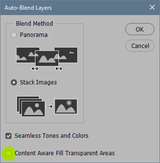

Something's wrong here. Photoshop will do this in seconds too. 10 x 45 MP is nothing out of the ordinary.
One thing that can throw this process off, is if you have "content-aware fill empty areas" checked. Make sure this is unchecked.
All that said, PS focus stacking has its shortcomings, and it may well be that Helicon Focus does a better job. Or Zerene Stacker. They are both specialized software for this.

Many thanks, but I didn’t find ‘content-aware fill empty areas’ on my last up to date PS (2021 - 22.5.0), and I buy a Helicon Focus license.
Best regards.
