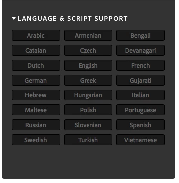

Hello, i'm from Ukraine and i decided to buy photoshop. I want to know if i buy photoshop, there will be fonts for all languages or just for English?
    Correct answer teachbit
    in the Adobe Cloud subscription Typekit is available as part of Adobe Creative Cloud (or as a standalone subscription). Most Creative Cloud subscriptions include a Typekit Portfolio plan with access to our full library of fonts; a few Creative Cloud options include a Typekit Free plan, with a subset of the fonts available. You can choose a typeface from one of Typekit's many foundry partners, then sync it to your desktop with Creative Cloud—or use it on the Web. Synced fonts are available for use inside all Creative Cloud apps, such as Photoshop or InDesign, as well as other desktop applications, such as Microsoft Word. You can search for fonts, that are compatible with certain languages:
