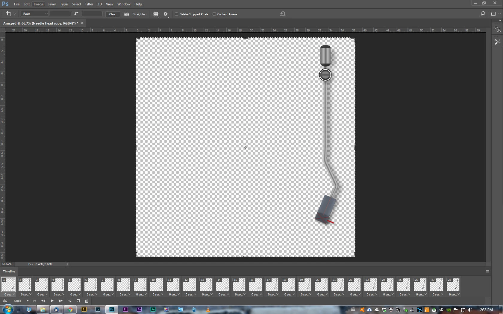

I've got a frame animation creating in PS CC2017.  It's a rotation of a frame element from 0 to 13 degrees in .5 degree steps over 26 frames.  I want to smooth out the movement a little more so am trying to tween the frames.

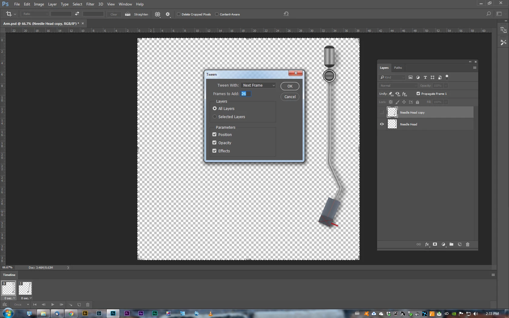

I hold Shift and select the first two frames, then click on the Tween button, select 2 as the number of additional frames to add and click OK.  The two additional frames are added, but the Opacity of the tweened frames is reduced and increases incrementally to the next full, original frame.
In the Tween dialogue, the dropdown has Selection (the only available option, the others are greyed out), Layers = Layers, and Parameters has all 3 options checked.  If I turn Opacity off the tweened frames are blank.

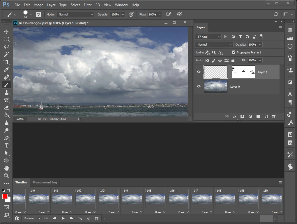

    Here I create two frames using two layer where one layer has a layer masked the is not linked the the layer's content and is a mask to composite the layer with the contents of the lower layer.  The top layer content was placed high and off canvas to the left and the second frame that the layer content was positioned low and off canvas to the right.  I user tween to generate 148 frames between the two frames I created using the two layers.  The opacity blending is was I expected the layer mask to produce.

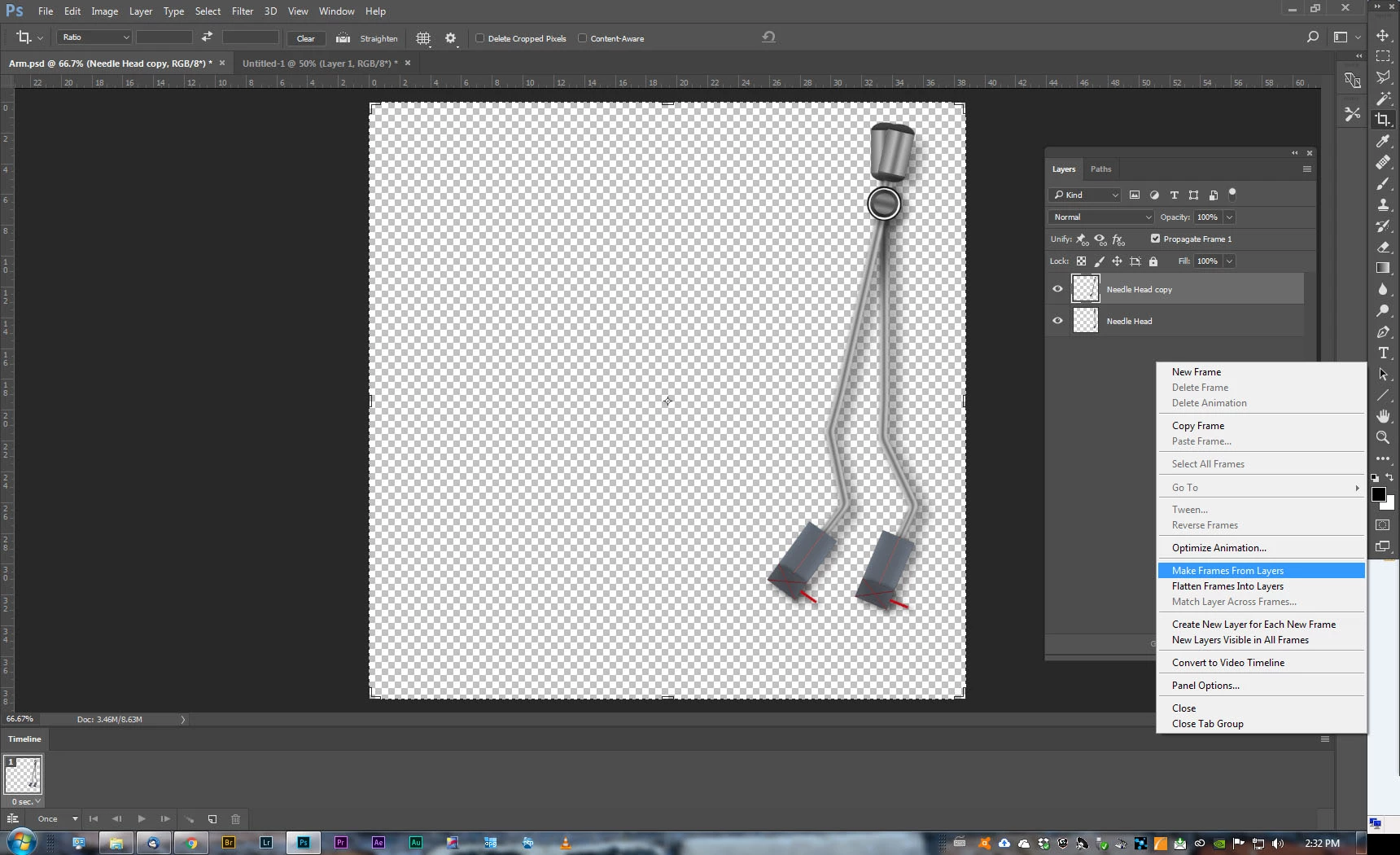

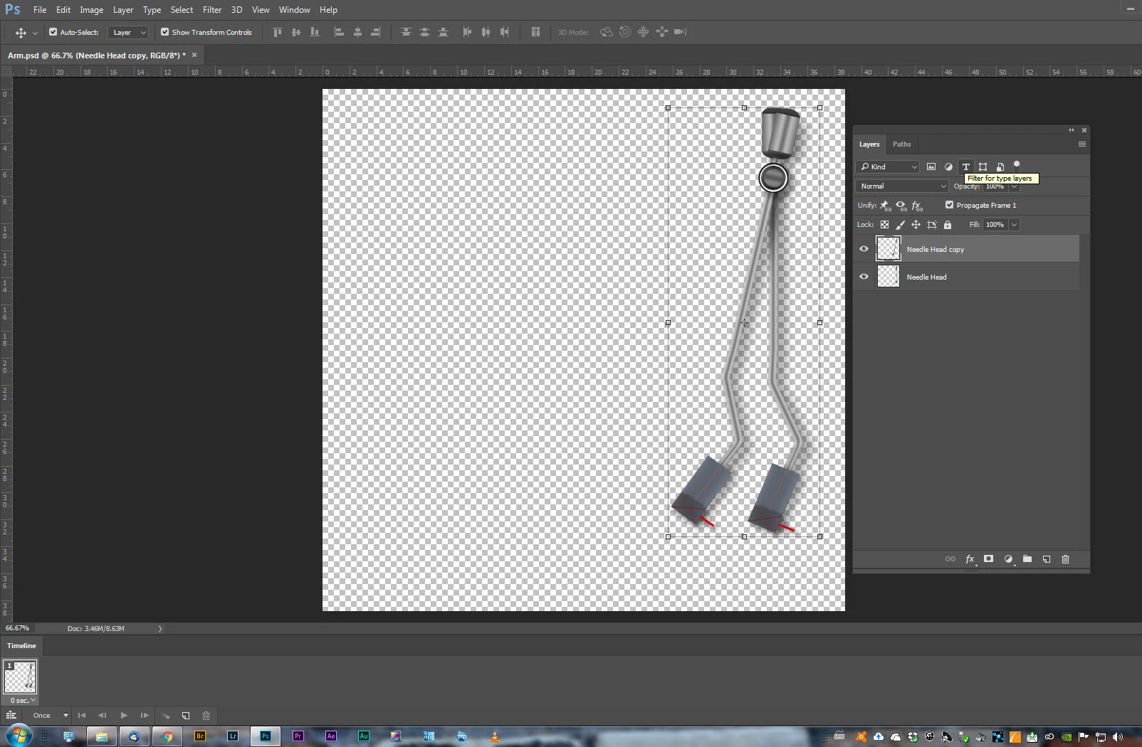

    OK, screen caps.
    I don't know if this will play properly, or not. This is the resulting animation.
    It should look like this, which was done by creating 26 separate frames, moving each one, then creating the frame animation.

    I never tried layer transforming to resize or rotate layers.  I just tried to do your turntable and it looks like tween layer position only supports layer position over the canvas.  I was not able to get layer rotation via transform to work with tween.  I had to resort to using a script to duplicate the layer and rotate it about a point by so many degrees, I could than use create frames from layer to create a frame animation the add a background visible in all frames.
