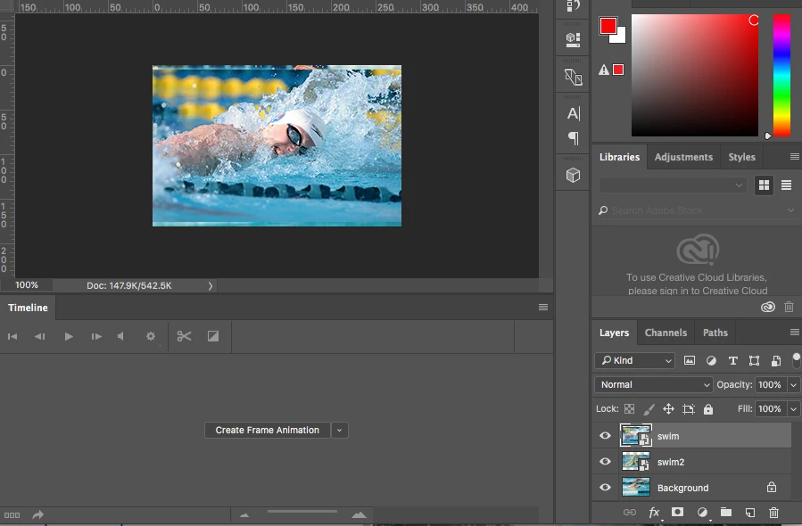

I'm testing to make a GIF in Phototshop cc 2017 but the frames are not showing in the Timeline.
I imported the layers, selected Timeline and then selected Create Frame animation but I can't see my layers in the timeline window, see attached screen grab.
What am I doing wrong? I have made GIF's in earlier versions and not had any problems.
Thanks.
    Correct answer Chuck Uebele
    You did click on the button that says, "Create Frame Animation" and not just select it from the dropdown list?

    Chuck Uebele
    Chuck UebeleCommunity ExpertCorrect answer
    August 2, 2017
    August 2, 2017
    Thanks, I didn't realize that it was a button. One frame shows now but not the other 2. Do you know how to make the other 2 frames visible?
    August 2, 2017
    I figured it out. If I select a frame and make the other layers invisible in the layers panel I can make the different frames. A bit backward, if I remember correctly the older Psd versions made it quicker and easier to make GIFs, but it has been a while so I might be wrong.
