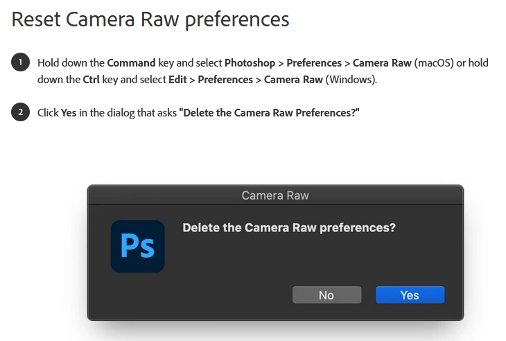

@Aurèle31758960chqm try resetting your ACR pereferences
August 22, 2024
Thanks a lot ! You saved my day at work !
