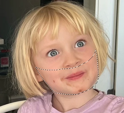

I opend a close-up photo of a person's face into PS 25.5.1.  I created a duplicate layer, outlined the area in the shape of a beard, and clicked Generative Fill, and entered "beard" for the prompt. The results were changes in the person's mouth expression, but no beard.

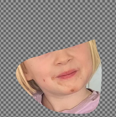

What I ended up doing was selecting the lower chin area and duplicating on to its own layer, then hiding the remaining image:
Thereby "tricking" the AI to ignore the age of the subject.
After generating, I simply turned the full image layer back on.
