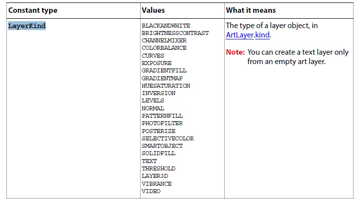

You can test if the Active Layer is a solid fill using LayerKind
However Shapes layers  can have a Gradient fill, Pattern fill, Solid Color fill, and no color fill.  With Action manager code you may be able to find out if the Active layer has any of these fills.  I do not see a LayerKind SHAPE.  R-bin may be able to help you with the Action Manager code need the get the information about the Active Layer.
