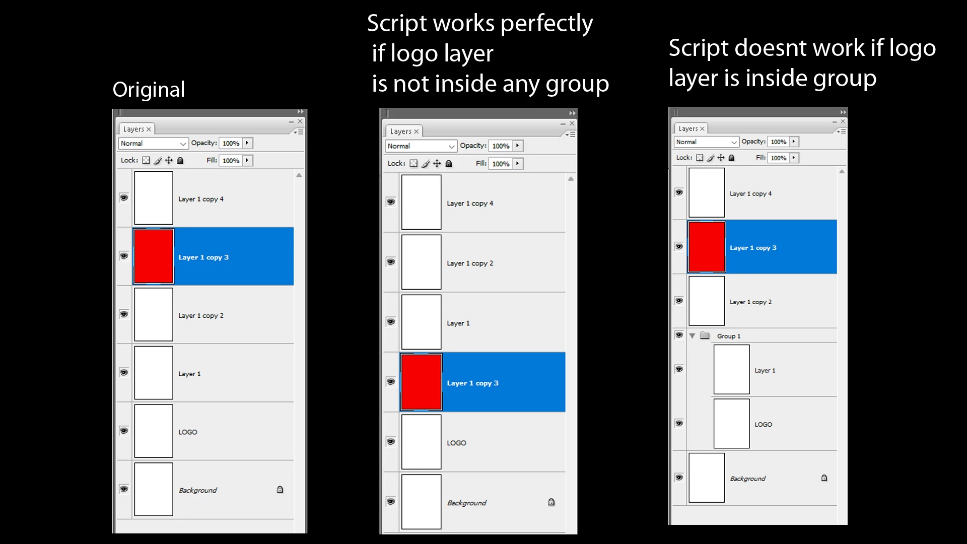

I have one script which move and place currently selected layer above the "LOGO" layer (LOGO is layer's name). Script is working perfectly when logo layer is not inside any group but if logo layer is inside any group this script doesn't work and give error
Error1302:NO such element
Line:6
-> var layerRef=app.activeDocument.layers.getByName('LOGO');
What changes are required in this script ? Kindly help. I am using photoshop cs3
Below is my current script
var doc=app.activeDocument;
var moveLayer = doc.activeLayer;
var layerRef = app.activeDocument.layers.getByName( 'LOGO' );
var targetLayer = layerRef;
moveLayer.move(targetLayer,ElementPlacement.PLACEBEFORE);

Hello sir, Thanks for the reply but your code is selecting  first layer found by name, even if it is inside nested layer sets of the same name (it only selected layers, not groups/sets).
Selecting LOGO layer is not an issue. I think I am not able to convey my message properly. Please check my original post. I want to move active layer above LOGO layer. I dont want to select LOGO layer. Please check the screenshot attached. The script which is posted in main post move the activelayer above LOGO layer if LOGO layer is not inside any group. Script doesnt work if LOGO layer is inside any group. In my original LOGO layer is used as layer referenece in line 6
I want to know how to make LOGO layer reference layer if it is inside group. Please check the screenshot attacted in my post.

The script mentioned in your link is searching the LOGO layer perfectly  but I am not able to place previously selected layer above logo layer. Please check the screenshot I uploaded with my main post.
