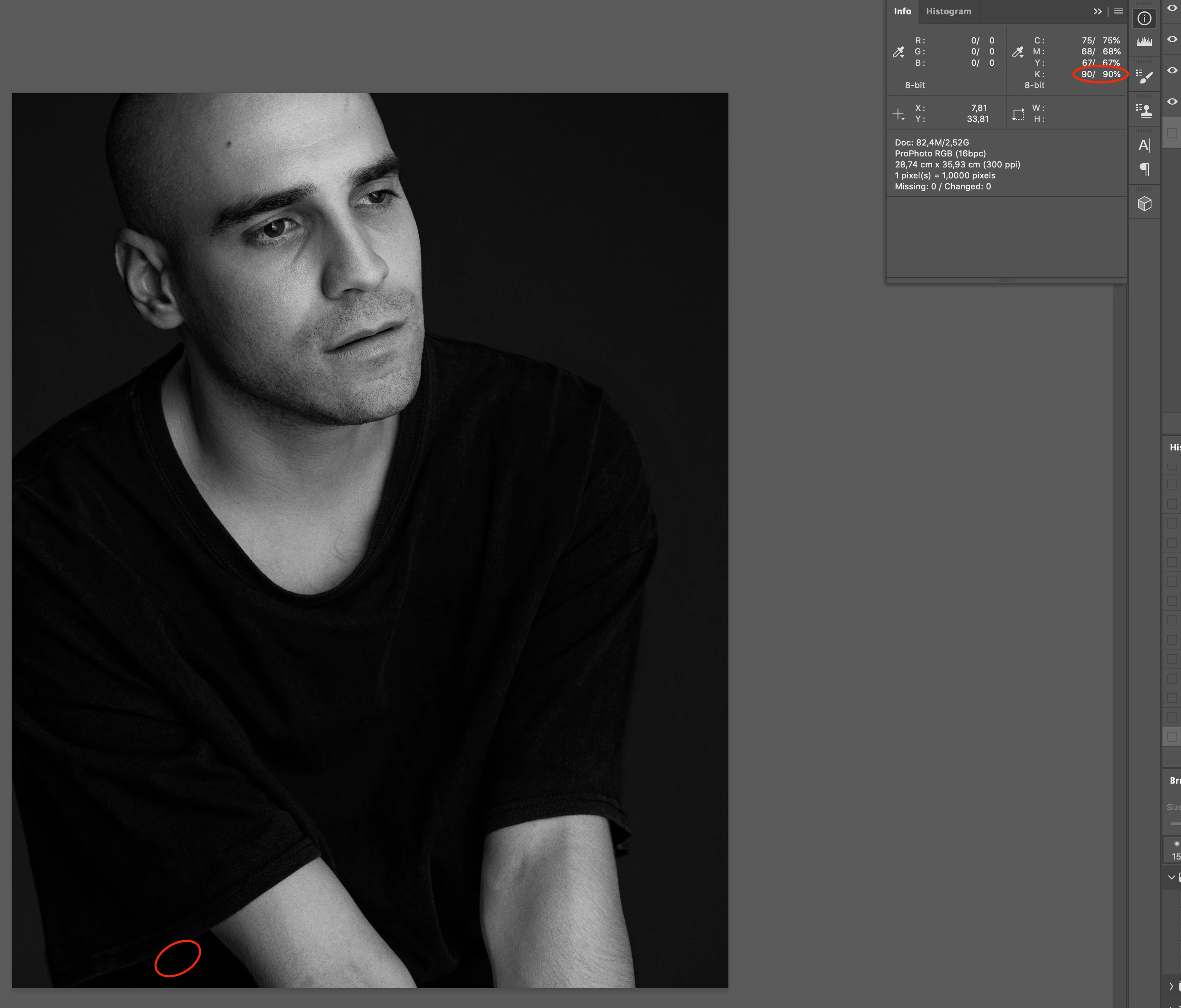

Hello everyone!
Am I doning something wrong or is my eyedropper tool giving me incorrect readings?
Basically when I sample area (hover over an area I want to get reading from) where I know it is clipped shadows, it tells me K=90%. But that should be 100%, no?
When I sample area where I know the highlights are not clipped, it tells me K=0%.

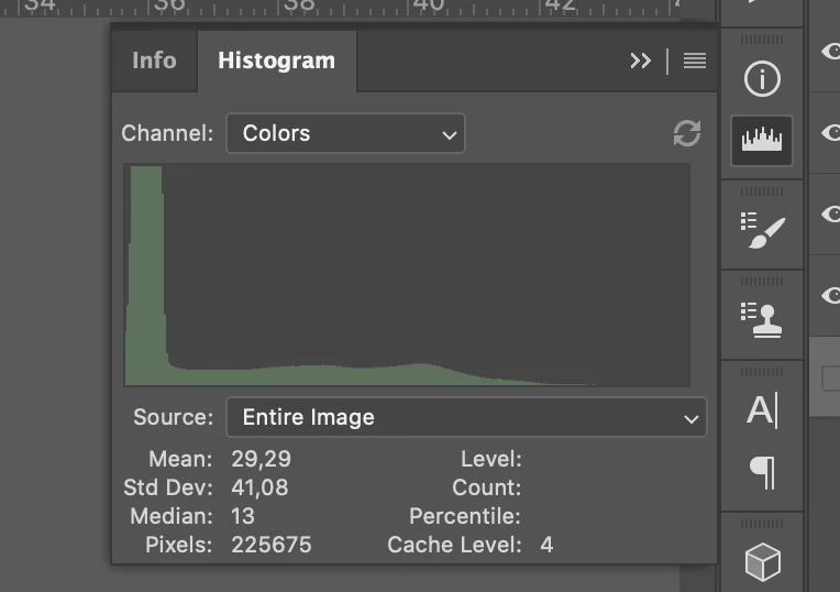

The histogram confirms that there are no clipped highlights and that there are clipped shadows.
It is really strange to me, but perhaps I am using it wrong?

Correct answer Dave Creamer of IDEAS
You are just reading the K channel. A lot of the tone is in the CMY channels. If you want just the K readout (essentially, merging all the colors) use the Panel Options menu to change our CMYK readout to Grayscale (K only).

Thank you so much, Creamer! It worked.
I knew I am dumb, but now there is a proof on the internet. : D
I was baffled why are there any values in CMY. I thought since it is B/W image there should be only K value. But I've dissmised it as part of the error. Turns out I don't know enough.

The CMYK values would happen if the image was printed as a 4-color black. This gets into the color management stuff that I won't go into now...
