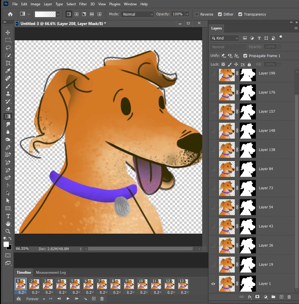

hello im having trouble with saving my gif on the preview in photoshop it looks normal but once i save for web or preview on the browser it looks all glitchy with ghost layers appearing i dont know what to do i tried lowering the file size as much as i could but it wasn't working and there is only a total of 10 frames in this gif if anyone could help id be really greatful thank you

A frame content is the composite of the layer stack visible layers for each frame. Here I start with all layer visible then in the next frame I remove one layer till  all  bu one layer is removed, Then I show one layer at a time in the next set of frames. I added a white bottom layer the is visible in all frames. You control the animation frame content using the layer palette the make each frame composite content.  You animation look like you are adding a layer to the previous frame content so you are getting  a multiple exposure build up. Your frame should only have one layer visible in each frame. Where you animation Builds up mine tears down. Them animates the layers one at a time.

The disposal mode is "do not dispose" and here is the link to the PSD file

So I masked some of the video layer from video you posted  to remove the checkerboard background. So the Layers would have a transparent background. Then created as frame animation. I had no issue. I simple used Make frames from layers.
