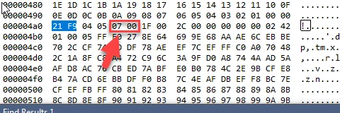

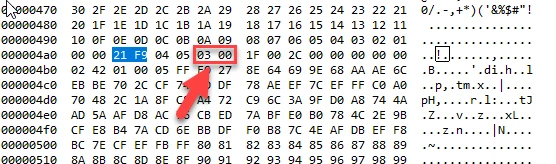

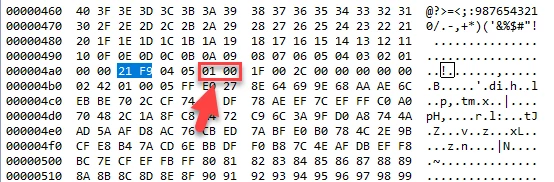

It looks like this is down to the way the frame delays are being interpreted by the player. I looked inside each of your files with a Hex editor and the frame delays on the first two are shown correctly
0.03 sec file
0.01 sec file
The third however is titled 0.07 secs but the frame delay in the file shown as 0.01
Your 0.07 sec file
So I took your 0.03 file and changed the frame delay to 0.07 and exported it.
It now shows the 0.07 correctly
So Photoshop is saving with the correct frame rate. It looks like you may have made an error when exporting your 0.07 s file.  The main issue though is whether the playback browser can play that rate or, as some do, if it gets too fast a rate changes it to a lower rate that it can play.
Dave

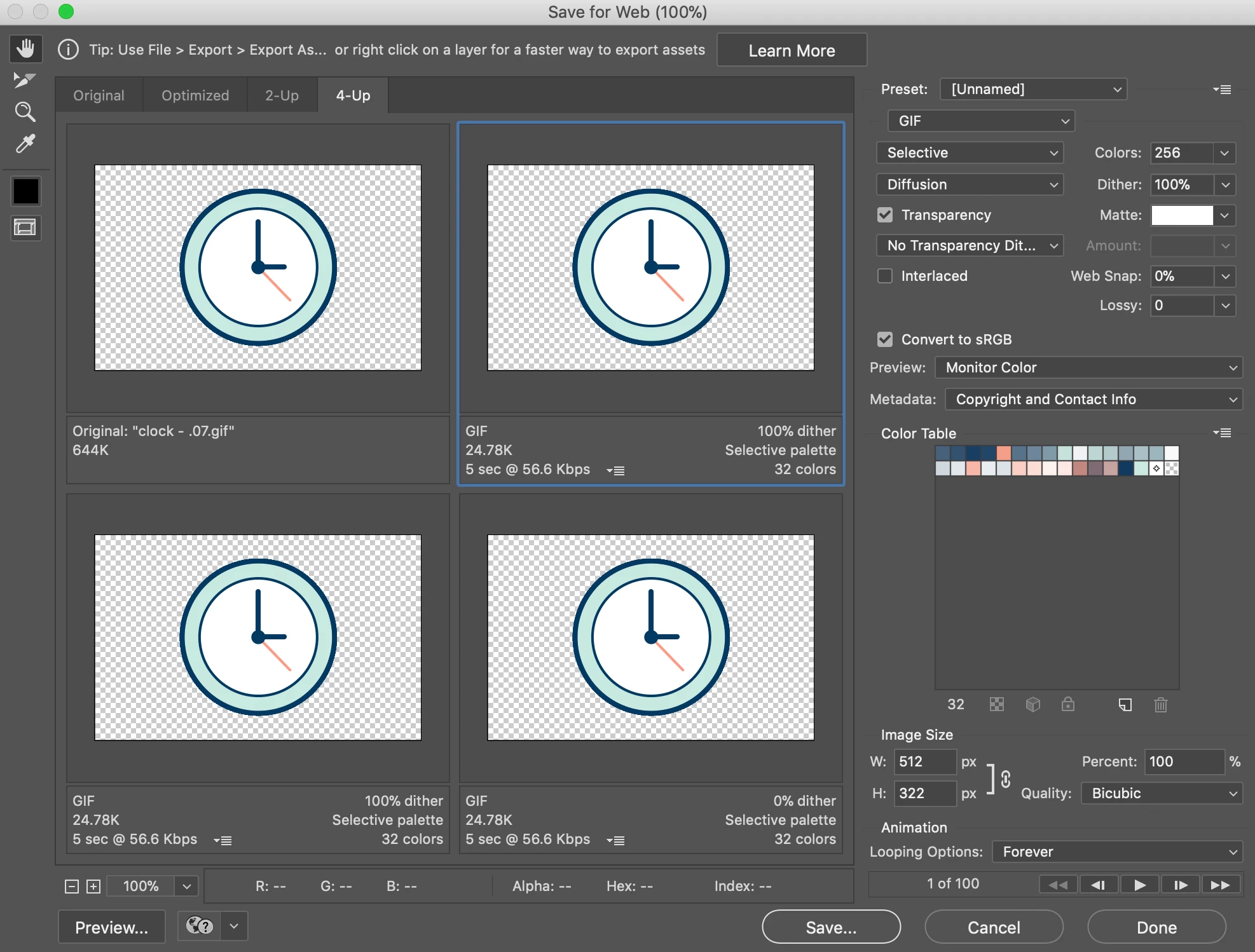

davesink2​! Thank you so much for the in-depth analysis. A few follow-ups if you don't mind ...
1) Why is the .03 image faster than the .01 image? Wouldn't a smaller delay mean a faster image?
2) Any advice on the mistake I am making in the export panel in the .07 image? Here are the settings I am using ...
THANK YOU!!!
