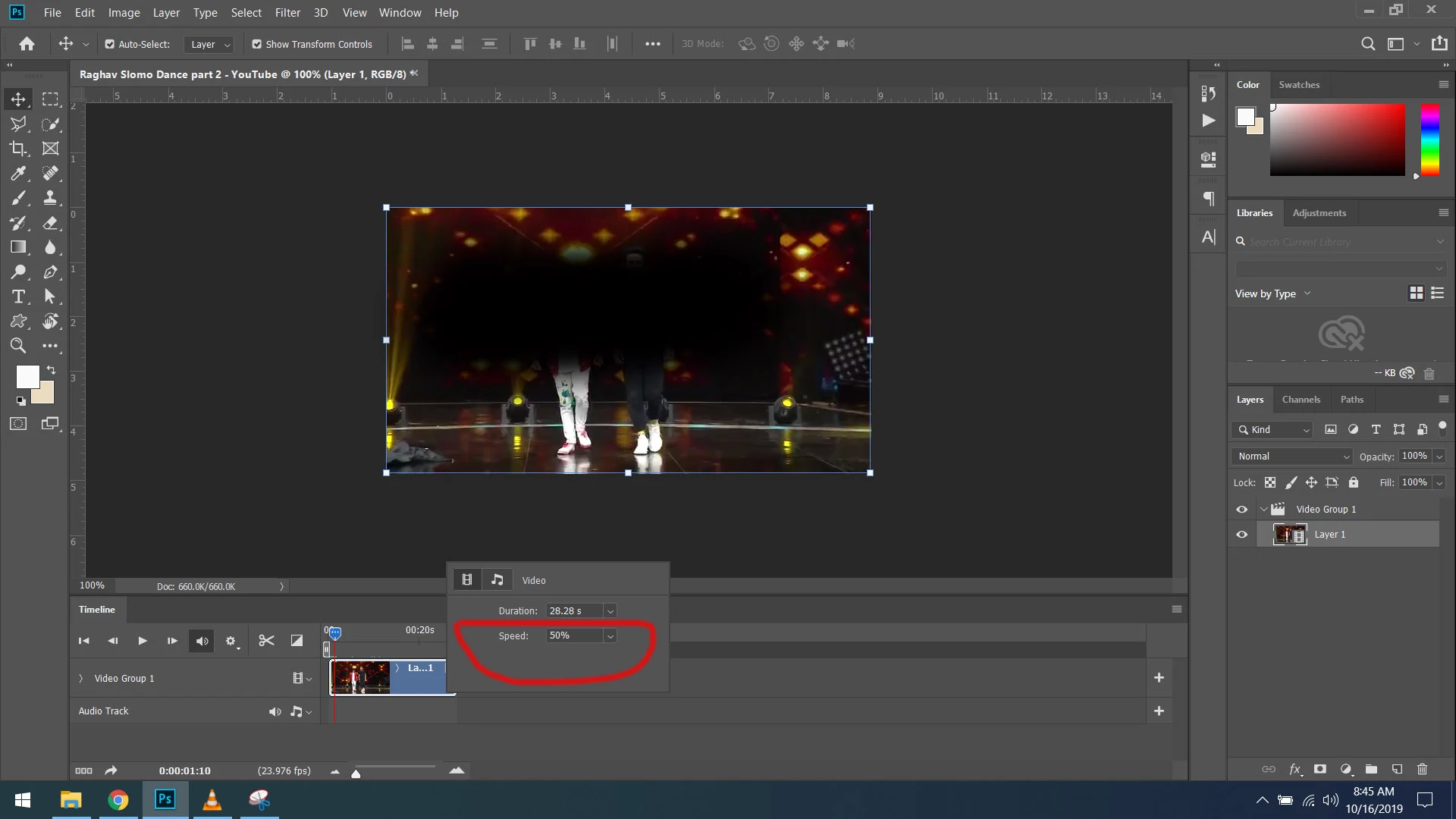

Hello there! I have a problem with my gif speed. I want it to have no delay but once i export it, the GIF speed seems way too fast and everytime i try to change it, it just keeps going back to where it was before. I attached a video to show my whole process just incase i dont get specific enough.
Im also new to gif making! you may skim through the video since there are a couple of loads that took a while to process. Thank you!
Correct answer lambiloon
click on play button where i made the circle then you get it...Regards

Hi
A gif has no fixed frame rate. If you want it to run at an approximate* speed then set a frame delay to match your required frame rate. Delay = 1/frame rate   Do not set it to zero as that will force playback as fast as the browser/play can play it.
*I say approximate because the actual playback speed will still be browser /player dependent. Set delay too short and the browser may limit it any way
Dave

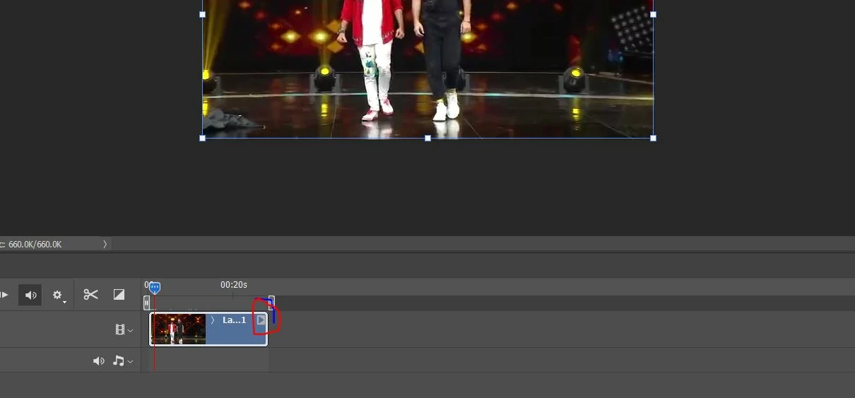

lambiloon
October 16, 2019
Check the Images hope your probelm will be solved...Regards

nini bearAuthor
October 16, 2019
Hi! How do I get the menu to pop up?
lambiloon
lambiloonCommunity ExpertCorrect answer
October 16, 2019
