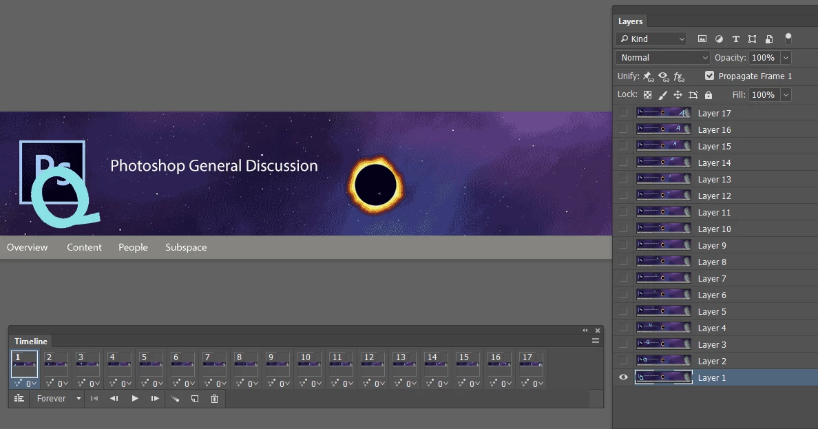

    Hi Sophie.

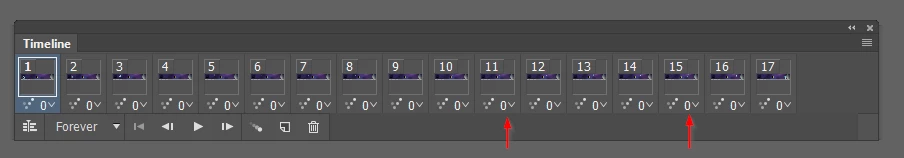

    Animated GIFs are a lot of fun, but they sure can trip you when you first start with them.   Check all the frame timings.  Are they all set to zero?  You can select frames the same as layers.  Click on the first frame, and Shift click the last, so you change all the times in one operation.
    Then click on each frame one at a time, and see if you only have the one layer turned on for that frame.  This is the biggest Gotcha with Photoshop frame animations IMO.  You make an edit, or you nudge something, and then discover that you had the wrong frame selected.  The problem is that that frame remembers your nudge, but none of the other frames do.  Rule of thumb is to have ALL frames selected when editing the background.
    If it plays OK on the timeline, then it should either work or not work when exported.  It shouldn't start to go crazy after export.
    NOTE:  If you are working on an existing animation, then they can sometimes be corrupted, but the only time we saw that here, it was showing the same corruption in the Photoshop timetime.
    The banner in my screen shot was from when all had a go at designing this forum's banner in this thread   That particular one is in post #35 and can be right clicked and Saved, and loaded into Photoshop.  Let us know where you are up to, and shout if you need any help.

    Hi Sophie.
