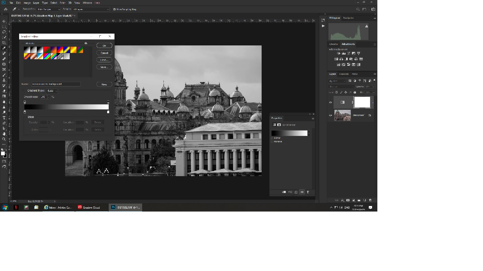

Thank you for the replies...Here is the screenshot for Dave...It appears to be the same as the attached video. Its the adjustment sliders on the black to white that have no affect.

mxwizard1
mxwizard1Author
April 23, 2019
Thank you Dave....After reading your reply I actually noticed that she stopped moving the slider and I suspect released it...So gradual didn't notice it....Great help on this one..
Thanks again.
Tim

davescm
April 23, 2019
Can you show a screenhot of your image with the layer panel visible, the gradient adjustment layer selected,  and the gradient editor open
