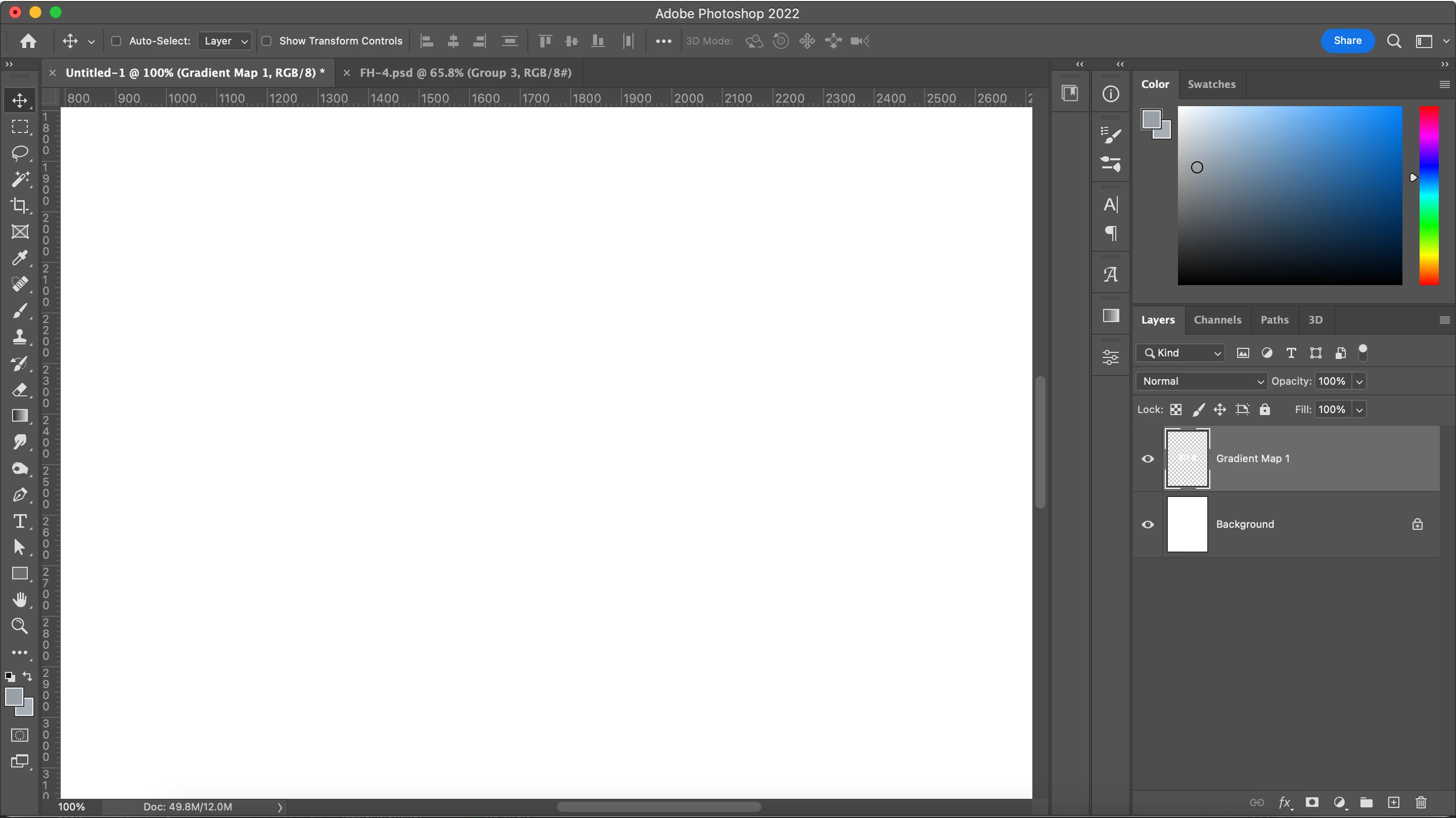

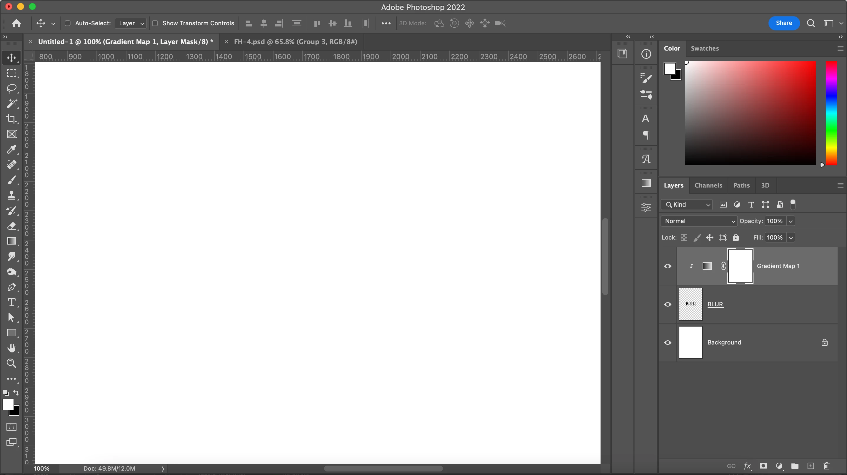

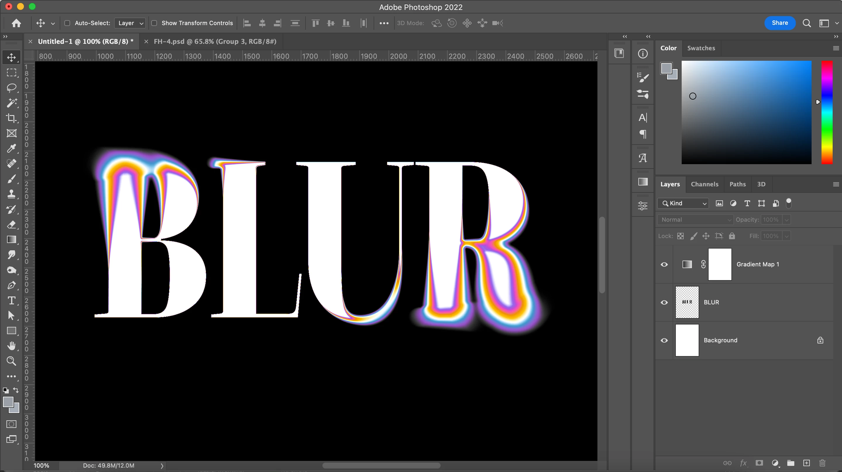

July 4, 2022
Absolutely!
The first is the type of effect I am playing around with, and the second and third image is what happens when I merge layers or clip the gradient map to the layer below.
Thanks!
c.pfaffenbichler
July 4, 2022
The Layer »BLUR« appears to be black, so that is as expected.
Do you understand what a Gradient Map Layer does?
If it is applied to a Layer that only has one color then the result would also be one color.
