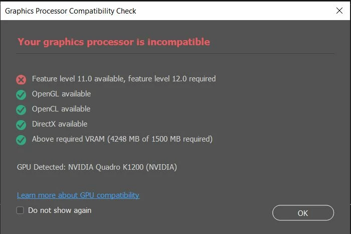

Hi, just updated to version 24.5 on Windows 10 and Nvidia Quadro K1200 with drivers updated and Photoshop warns about incompatibility of my graphic card. No problems till the previous update, so what have you done with the newest one?
Correct answer Ged_Traynor
@Da7 according to the tech spec for that GPU, it only supports DirectX 11, Photoshop requires a GPU with full DirectX 12 support
https://www.bhphotovideo.com/lit_files/153287.pdf
https://helpx.adobe.com/ie/photoshop/system-requirements.html

Ged_Traynor
May 26, 2023
@Da7 not that I'm aware of, but any GPU that's 4 years old or less would be fine, something like an RXT 3060 would be a good option

Is there an Adobe official supported graphic card list?
Ged_Traynor
May 26, 2023
@Da7 Photoshop is becoming a more GPU intensive application with each update and this will affect people with older GPU's

Ok but with v. 24.4 everything still works fine. So I guess things are changed from the 24.5
