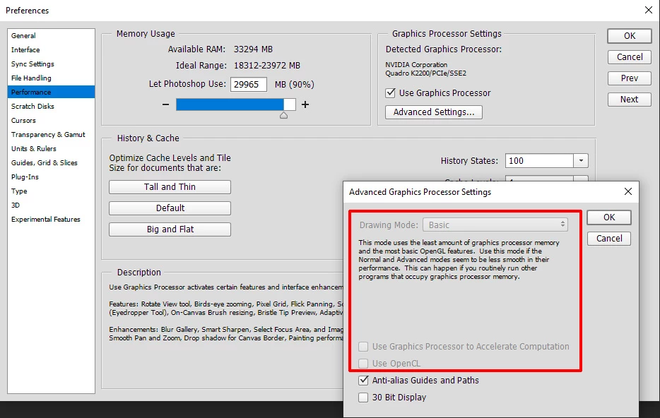

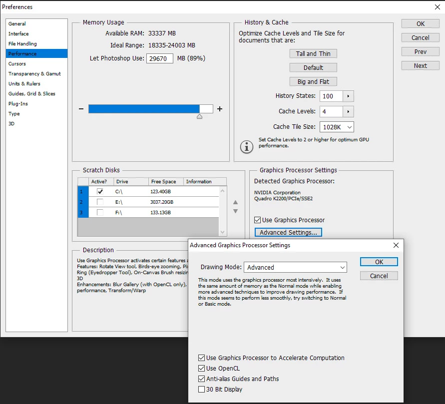

    JJMack
    August 10, 2019
    If resetting you preferences does nor resolve your problem try reinstalling you Nvidia Device driver. Particulary if you just updated windows 10 version 1809 to version 1903.  My Nvidia Quadro Drivets messes up when I updated windoes Photoshop hanf pronlem.  And now the newest driver I can noe uset some of the Advances GPU settins I uset to be ad to use in CC 2014.   I can use the settinc in CS6, cc 2018 and  CC 2019. The are only unavailable in CC 2914.
    In CS6, CC 2018 and CC 2019 I set these
