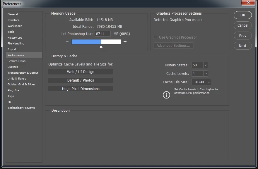

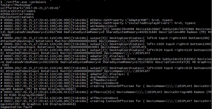

When using the lastest version of Photoshop with my computer (HP Prodesk 600 G2) with AMD Radeon R9 M360 and integrated Intel HD Graphics 530 Running Windows 7 (Build 7601) the "graphics processor" is blank and grayed out under performance. Sniffer.exe also crashes with the configurations. Below screenshot of it running with -verbose=1 shows a segmentation fault during execution while processing the Intel card. And when opening a file, the message about minimum vram requirements for 3d features shows.

    This is correct. The computer is also a desktop, which means that the automatic switching function that is referenced in the troubleshooting is not a feature, as it is only available for laptops as part of the power options. That leave the option of disabled the integrated graphics which is and unacceptable solution, as i need it to support my workstation's screen. I have also verified that windows, Photoshop and the relevant drives are up to date with the manufactures.
    This issue lies in the underlying application, and the sniffer.exe (or another component) crashing during execution. I was hoping someone from Adobe might want logs or crash dump files of some sort that might help them diagnose the issue.
