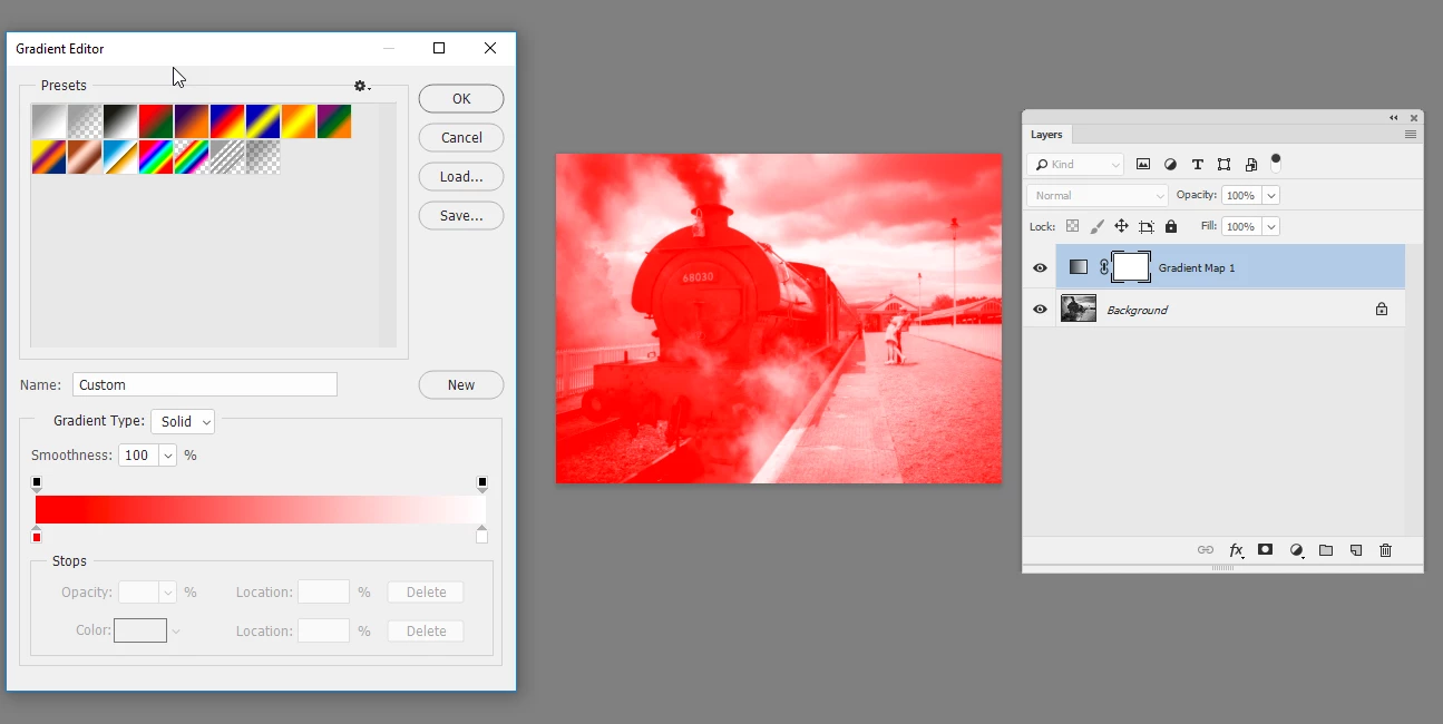

    Meilleure réponse par davescm
    Switch the greyscale image to RGB mode then add a Gradient Map adjustment layer setting the gradient to achieve the colours you require
    Dave

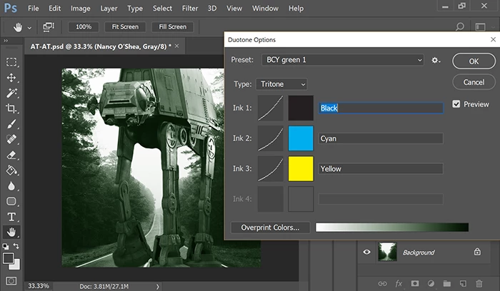

    Nancy OShea
    June 30, 2018
    Change your Grayscale Image Mode to Duotone.
    Adjust options as desired or use one of the Presets as shown below.
    davescm
    davescmCommunity ExpertRéponse
    June 30, 2018
    Dave
