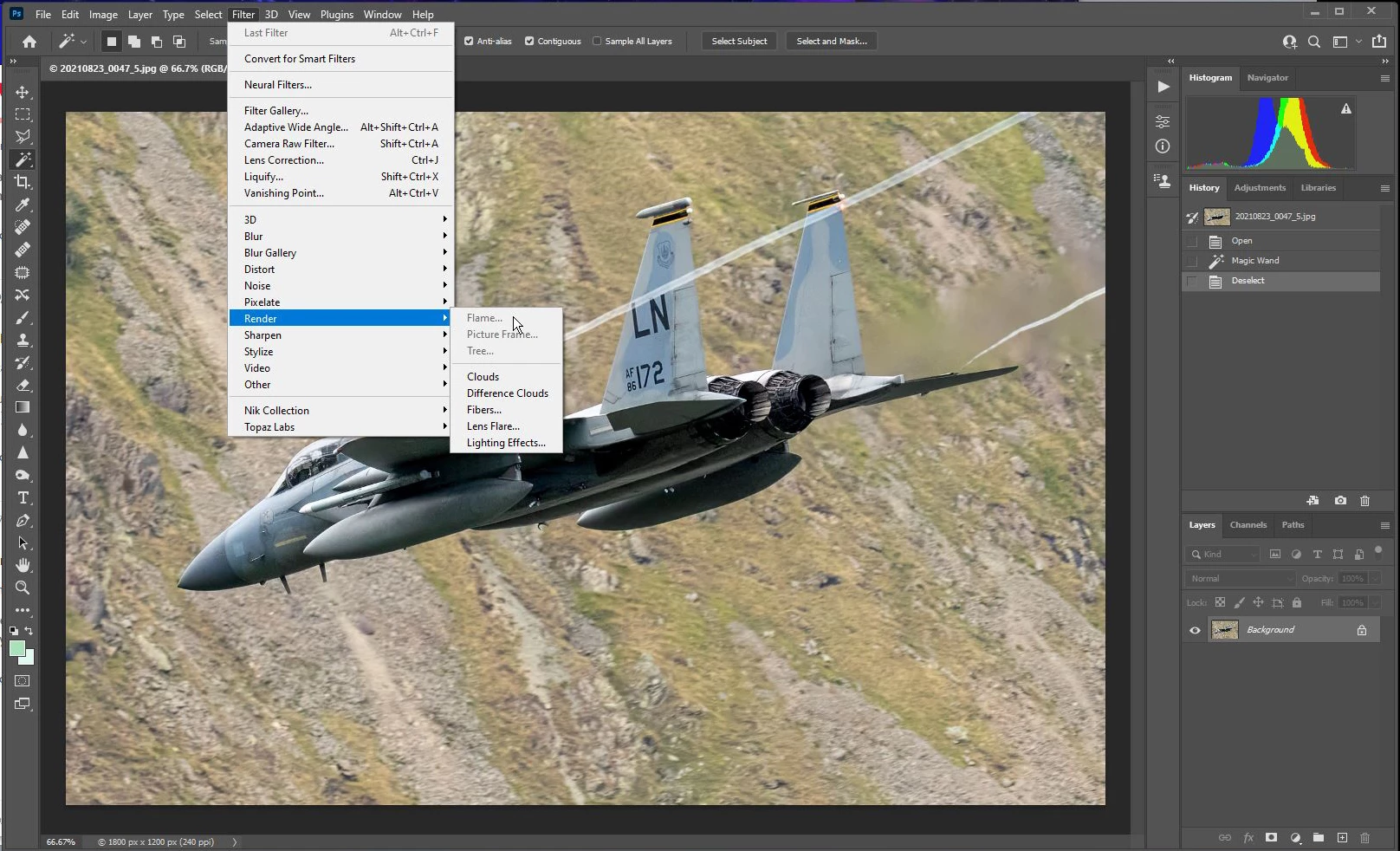

Greyed out Filter --> Render --> Picture frame
  • August 24, 2021
  • 1715 views
I was using the render pictrure frame until it suddenly stopped working and is greyed out.  As you can see from the image attachment. it is only the top three athat ar no longer availble ie Frame, Picture Frame and Tree.  The others below it are still available
It stopped wortking after I played with lighting affects.  I have tried various photos but the options are still greyed out.
I am sure it is an easy fix...  but cannot work it out myself.  Thank you in advance.

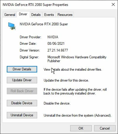

I got this working by repeating the action. I used Lighting effects on another photo and when I went back to Photo frame it was useable again.  Not sure how this fixed the issue.   My graphics card surpasses the minimum requirements It is a Nvidia GeForce RTX 2080 Super. Thank you for replying
PECourtejoie
September 1, 2021
Hi, is there also an integrated video card?
Please post the contents of help>system info, so that we get to know your OS, its version, the exact version of Photoshop you are running, the date of the GPU driver, if the GPU sniffer crashed, etc.
andys16903412
September 1, 2021
Attached is an export of system info (I am not 100% sure how to do this correctly so please excuse me if it's not what you asked) and a graphics driver detail.  Photoshop is latest version Adobe Photoshop Version: 22.5.0 20210809.r.384 ce617de x64.   I do not understand what a GPU sniffer is sorry.   Hope this helps

That feature requires a compatible graphics card to work.
I suspect your graphics card has been disabled. Make sure your card is supported: https://helpx.adobe.com/photoshop/kb/photoshop-cc-gpu-card-faq.html
Then make sure the driver is up to date and try other troubleshooting here: https://helpx.adobe.com/photoshop/kb/troubleshoot-gpu-graphics-card.html#DisableGraphicsProcessor
