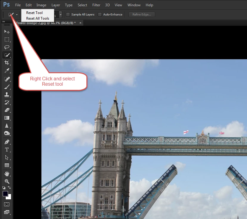

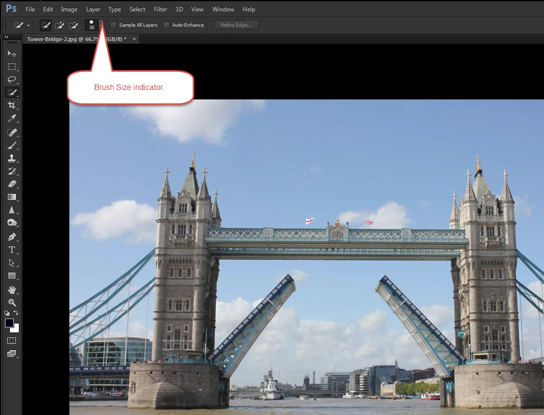

You will just get a cross if the brush size is very tiny. Next time it happens look on the tool bar to see what the brush size is. I don't see how this could  happen so randomly though. Are you using a mouse or a tablet? Try resetting the tool as shown.
