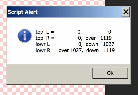

Here is the script I wrote based on JJ's four guides script. I simplified the code a little bit and it works. I tested it on Adobe Photoshop CC2017.
The script retrieves the position of four guides and then crops the image exactly by snapping on those guides. You have to have four and only four guides in order for script to do the cropping. You can position those guides manually or you could use the popular extension for Photoshop called GuideGuide.

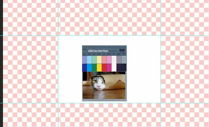

Its not moving the guides it resizing the layer, moving the layer to the guides and masking the layer.
JJMack
May 4, 2016
and the guides have been moved
JJMack
May 4, 2016
The script move no guides it fits the layer to the guides the results should look like a centered aspect ratio centered crop of the layer. Nothing is cropped the layers is just resized for the area and moved to the guides and masked to the aspect ratio.  The layer size was changed and the layer was moved.  The guide are where you set them.

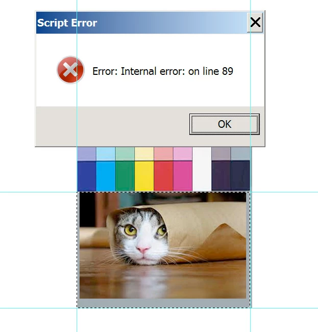

I commented out the 3 lines with " app.preferences.interpolation" in them.  Ran the script. The result shows that something outside the cat has not been removed. the guides are still there, although easily removed with an action.  So I need an alternative method to app.preferences.interpolation.  Also, for some reason, the script now does not crop to the inner triangle.  So app.preferences.interpolation is important.
JJMack
May 4, 2016
Your on the perpetual version of CS6 Adobe introduced a bug in script in CS6 they have fixed it in the subscription version of CS6,
Set your Photoshop Preference for default Image Interpolation form  Adobe default Bicubic Automatic to any other setting.  Bicibic Automatic is a bad default choice to begin with and CS6 scripting can not even retrieve that setting a  general internal error is generated instead,  My script is trying to save your setting so it can set the interpolation method I want to use then restore your setting.

JJMack
May 3, 2016
Great!
JJMack
May 3, 2016
That look like it may be canvas size a backgroung layer.  Layers do not need to be canvas size or even over the canvas.  Many kate bounds do not have a 0.0 origin. All  layer bound are rectangle bit the layer can have emoth oixel be any shape.
This script will set guides on layer bounds and and across its bounds centers.

May 3, 2016
Hi JJMack: Thank you,.  I can get the "coordinates" of a layer with the following code (couldn't figure out if there is a way to set the font in an alert statement); but have not yet tried to use the exposed variables with placing guides or doing a crop.
#target photoshop
// bring application forward for double-click events
app.bringToFront();
// Save the current preferences
var startRulerUnits = app.preferences.rulerUnits;
// Set Photoshop to use pixels
app.preferences.rulerUnits = Units.PIXELS;
var LB = activeDocument.activeLayer.bounds;
$.writeln(LB);
//alert("ok",LB);
var LWidth = (LB[2].value) - (LB[0].value);
var LHeight = (LB[3].value) - (LB[1].value);
sp1 = pad (" ",14," ");
sp2 = pad (" ",19," ");
sp3 = pad (" ",2," ");
sp4 = pad (" ",17," ");
sp5 = pad (" ",3," ");
alert
"top  L = " +sp1+      LB[0].value + "," +sp4+                LB[1].value + "\n" +
"top  R = " +sp1+      LB[0].value + "," +sp3+ "over"  +sp5+  LB[2].value + "\n" +
"lowr L = " +sp1+      LB[0].value + "," +sp3+ "down"  +sp5+  LB[3].value + "\n" +
"lowr R = "+" over " + LB[3].value + "," +sp3+ "down"  +sp5+  LB[2].value + "\n"
// Return the app preferences
app.preferences.rulerUnits = startRulerUnits;
function pad ( orig , count , padWith ) {
//-- eps@electronicpublishingsupport.com
var padChar = "0" ;
//-- but if they sent something, use the first character of it
if ( padWith != undefined ) { padChar = String (padWith).substr (0,1) ; }
//-- Convert to a string (actually adding the "" to it would have worked.)
var withThis = String ( orig ) + '' ;
//-- Check its length, with it is long enought return. Until then keep
//--  adding the padChar
while ( count > withThis.length) {
  withThis = padChar + withThis;
//-- Back to the caller
return withThis;
May 2, 2016
Thank you TEvashkevich:  I need to do this to a number of photos.  Sometimes the swatch is on top, sometimes on the side, etc.  I always have to zoom in to figure out just where the last guide should be placed. Some images need to be rotated, etc.  Once I figure out (or someone else does) the crop script, I thought that I might use the configurator, to create a panel, with different icons: one for the case where the swatch was on the bottom, etc.  Since I am new to adobe scripting, it is hard for me to know whether I should use scriptUI, or what.  But the scripts are running very fast out of the ExtendScript Tool, although the variable window takes some getting used to.  And, in the main screen, in debug mode, if you hold your mouse over a variable, it doesn't show its value.  Thanks again, Steve
999tevashkevich
May 2, 2016
Yeah extendscript is garbage for debugging (imo...)
I'll see if I can whip you up something (I'll likely just toss it through config anyways cause if I'm gonna make a UI I mid as well just do that anyways)
