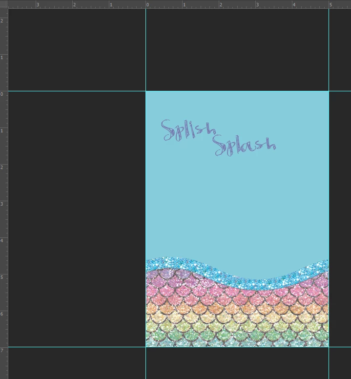

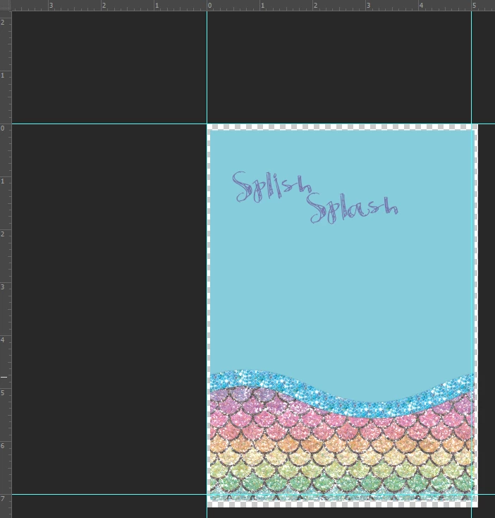

Basically I'm trying to create a 5x7 card/invitation, which I've done before (it will be saved as a png file). But I noticed when I checked the website where I'll upload to create the card to print it says "5x7 Flat Double Sided — Design Details: 5.125" x 7.25",  300ppi, 0.125" bleed on both short sides, 0.25" bleed on both long sides" — which I understand, but getting Photoshop to add the bleed space seems to be an issue for me.
When I take my 5x7 image with the snapped to document bounds guides (even if I lock them) when I expand the size of the canvas, the top and left margin guide move to 0 while the 5" and 7" guide stay at 5 and 7. I must be missing a step or a setting.  Here are two images. One at canvas size of 5x7 and one at canvas size of 5.125 x 7.25.
davescm
davescmCommunity ExpertCorrect answer
March 6, 2019
Hi
Uncheck "lock guides".
I've just tried it here. With lock guides checked they lock in place to the new canvas 0,0 point, although your image is no longer there.
Unlocked, they stay with the image edge i.e. move to the new image position.
Dave
