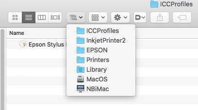

Navigate to
Your hard disk name”/library/ printers/EPSON/InkjetPrinter2/ICCProfiles/ [hidden inside a “package”]
[Not in the “your username”/library/ ]
Screenshot below

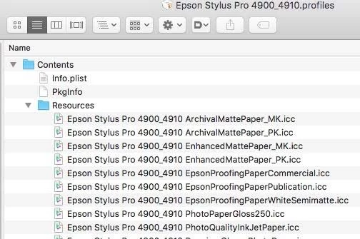

Inside the ICCProfiles folder (see above) is another folder containing the printer name, e.g:  Epson Stylus Pro 4900_4910.profiles
If you right click [or ‘control’ click] it and select "show package contents"
A contents folder appears
Now look inside that folder and you’ll find the ”resources" folder.
see screenshot below
These are the icc profiles which used within the Epson driver [e.g. when you select Photoshop’s 'printer manages colour' option],
DO NOT DELETE OR MOVE THEM. It’s OK to copy of course.

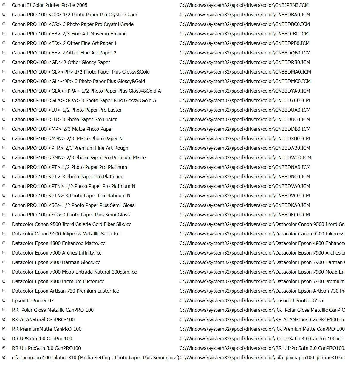

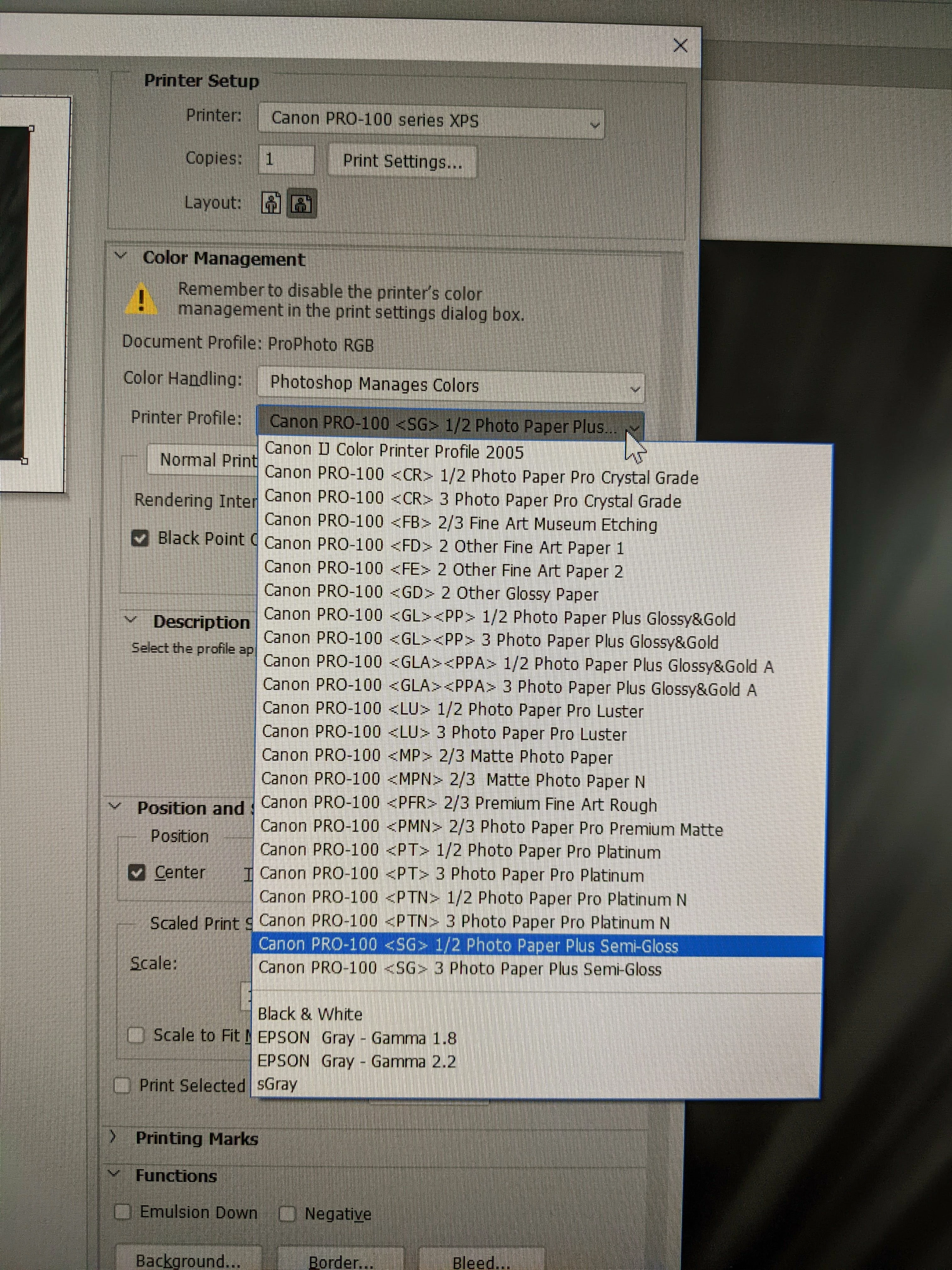

Attached are screen shotes of the printer profiles available in Ps and Lr. It may, or may not, be worth noting that all the profiles available in Lr are also available in Ps when cutomizing for soft proofing, but not for printing.
The 1st shot is Lr
Then this one in Ps (had to shoot with phone)
