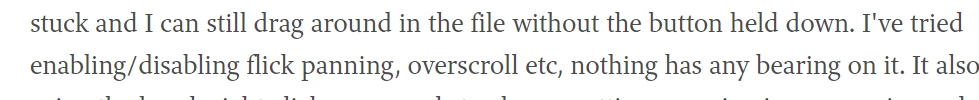

I have been having an issue when using the hand tool shortcut.
When I click and drag with the mouse, releasing left click does not stop the pan - instead it seems stuck and I can still drag around in the file without the button held down. I've tried enabling/disabling flick panning, overscroll etc, nothing has any bearing on it. It also happens when using the brush right click commands to change settings, causing innacuraccies and slowdowns. This is primarily an issue on my work machine, so I really do need a fix! It's hurting my productivity. On my home machine I don't have this issue - however some research tells me others have encountered it too. Any advice?
