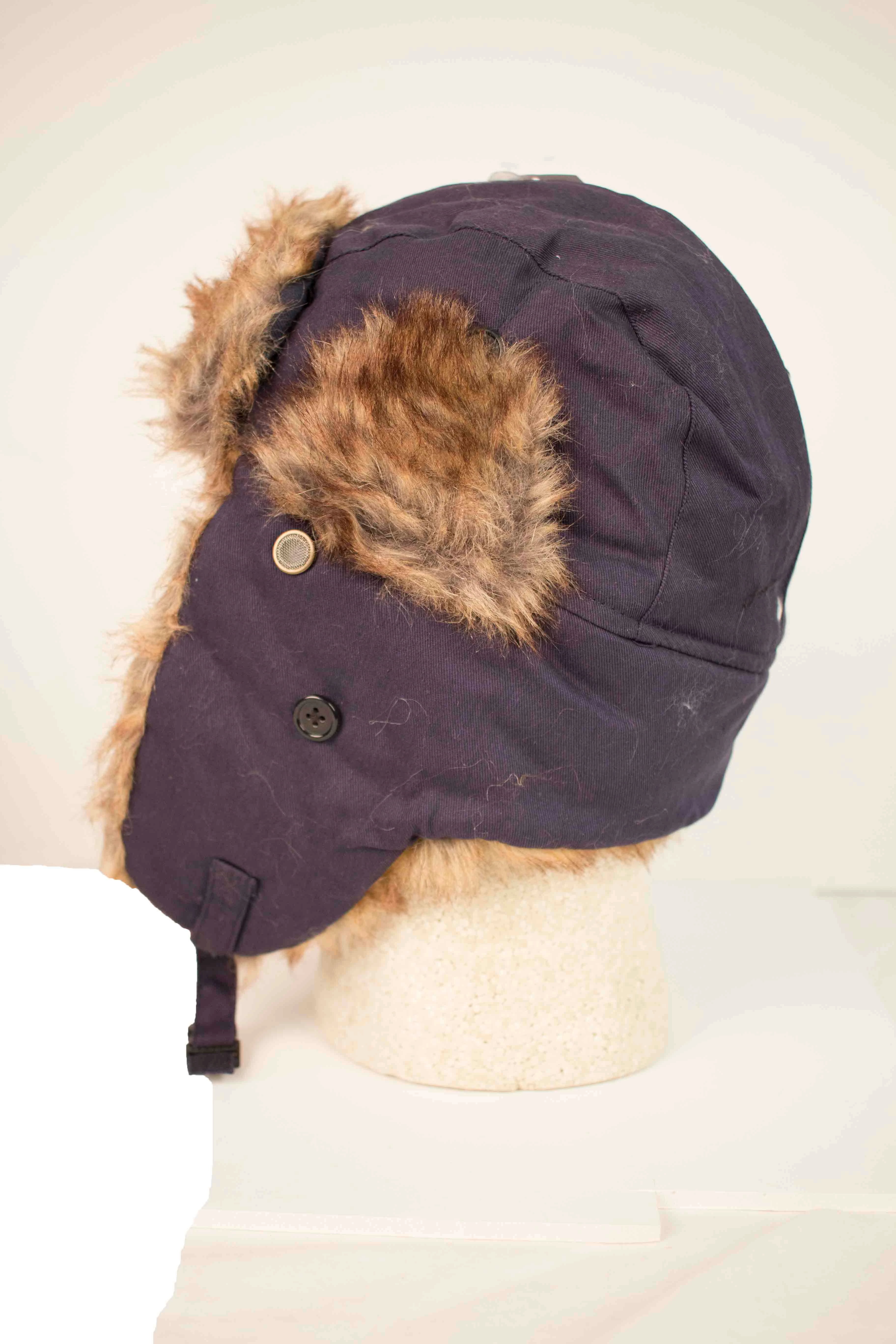

Took some product photos and having a hard time using quick selction tool to isolate item and change background color to white.  Any ideas how to make this easier. Hard part is I want to keep the base of the styrofoam head I used and the color closely matches the background.

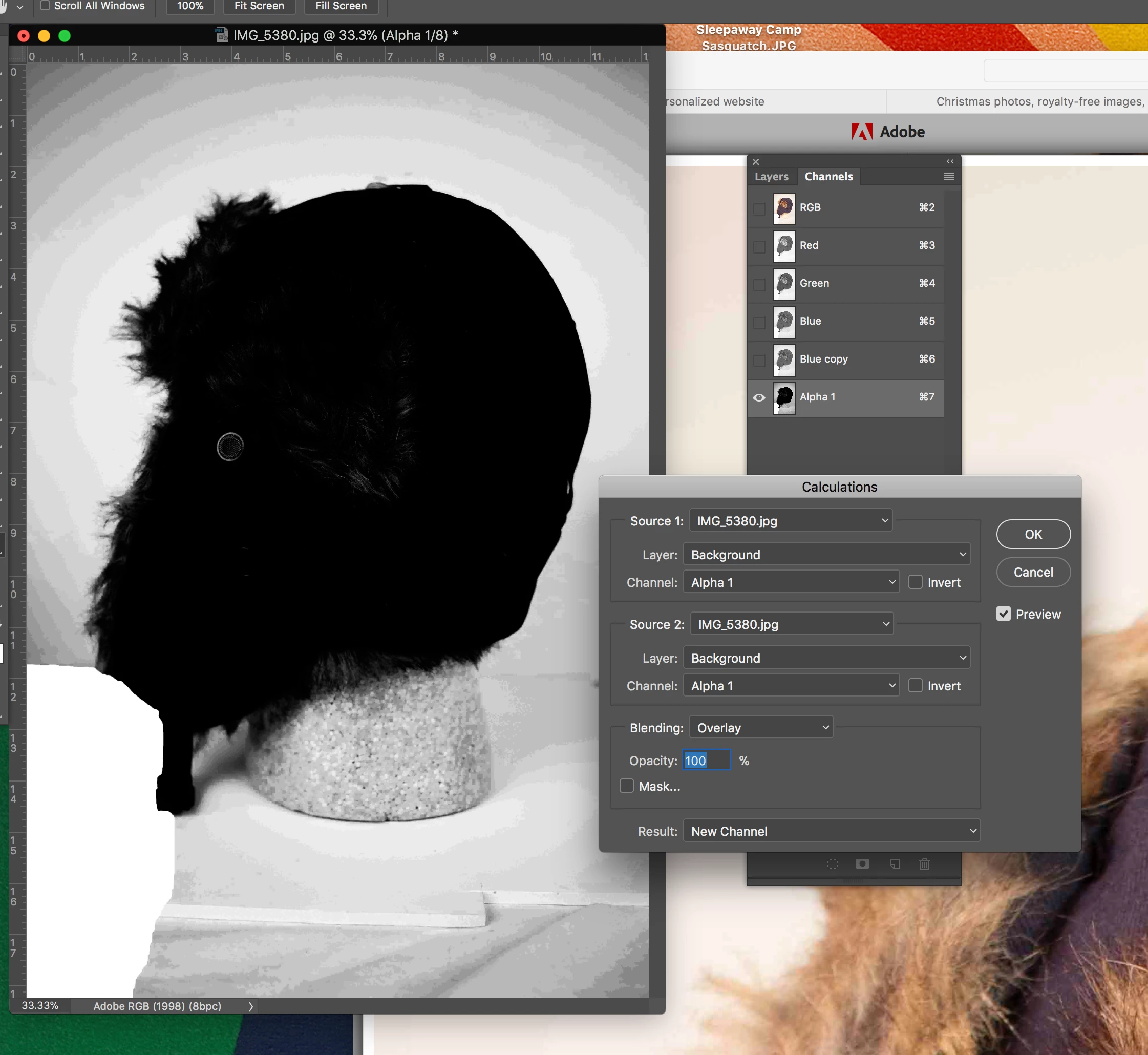

    My reply was similar to the above. Its really a job for the channels and refine mask command. I see you wanted to keep the styrofoam base. This is totally achievable. Since the hat is principally dark, and you ought to shoot against a light background, there are still ways to manually select the base, but I was still able to keep it with channels. Here's how I achieved it:

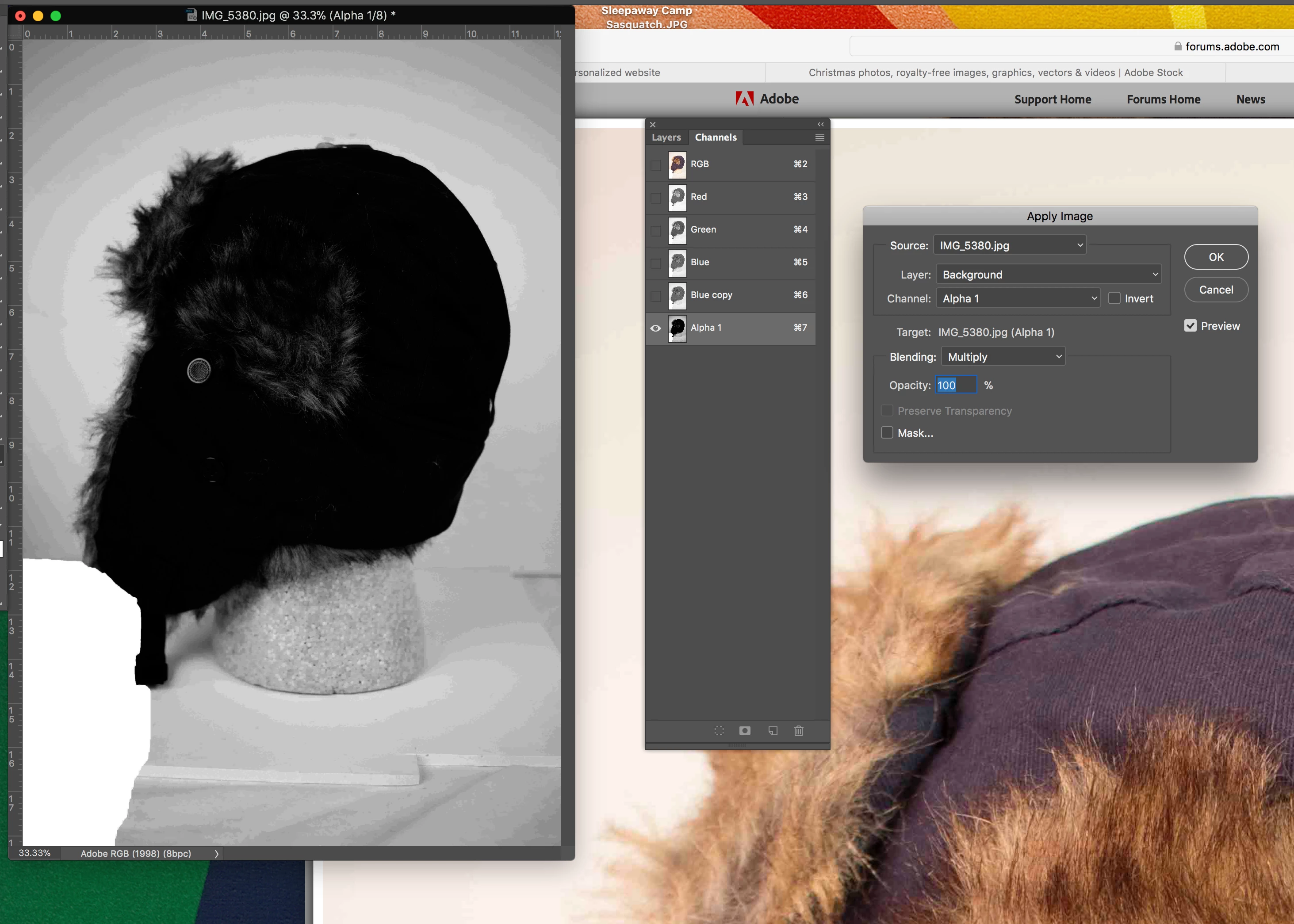

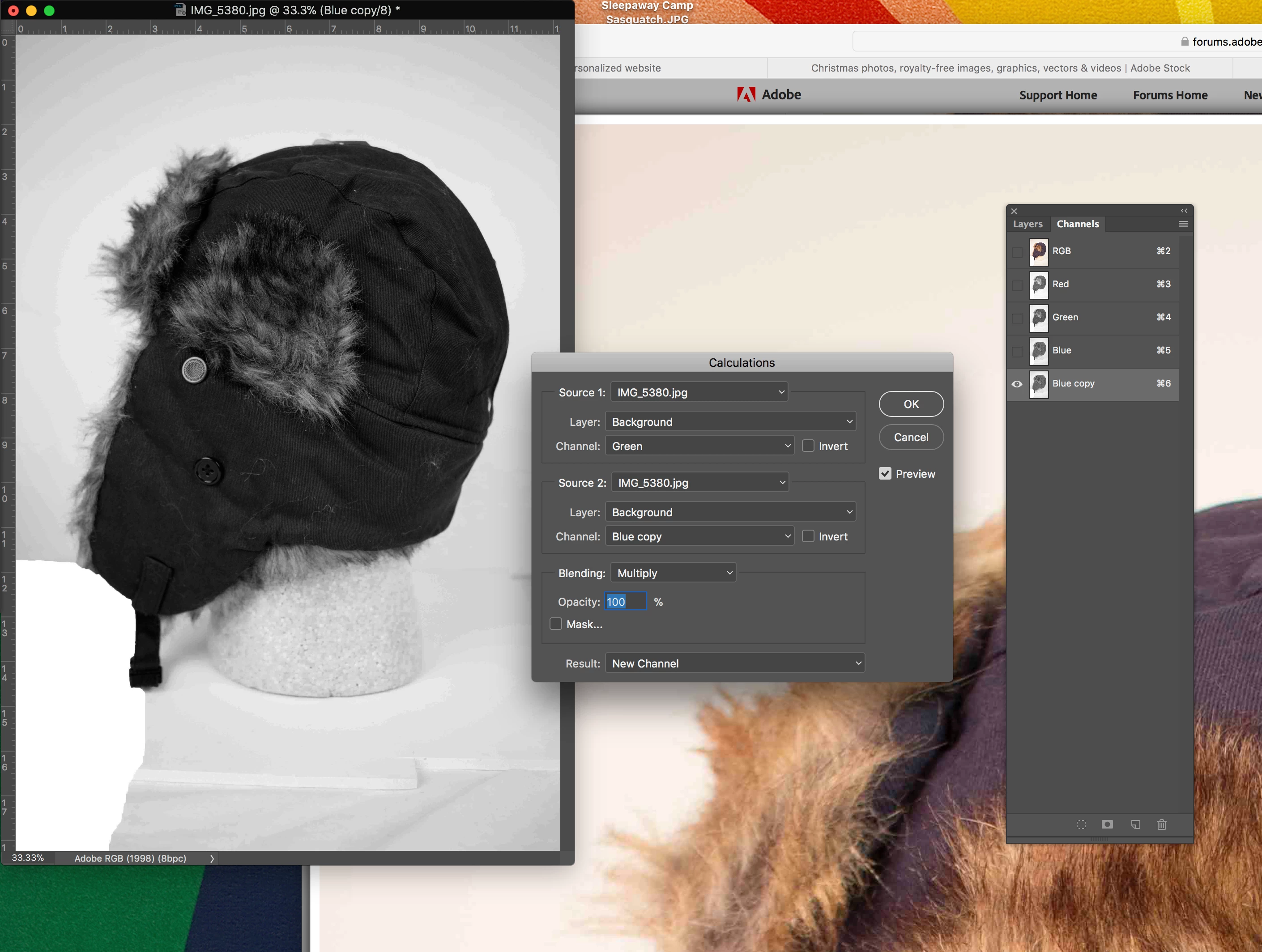

    I duplicated the blue channel, since it was a good base to begin a mask. I multiplied green channel via the calculations command to darken the image.
    I multiplied the resulting alpha channel onto itself with the apply image command.

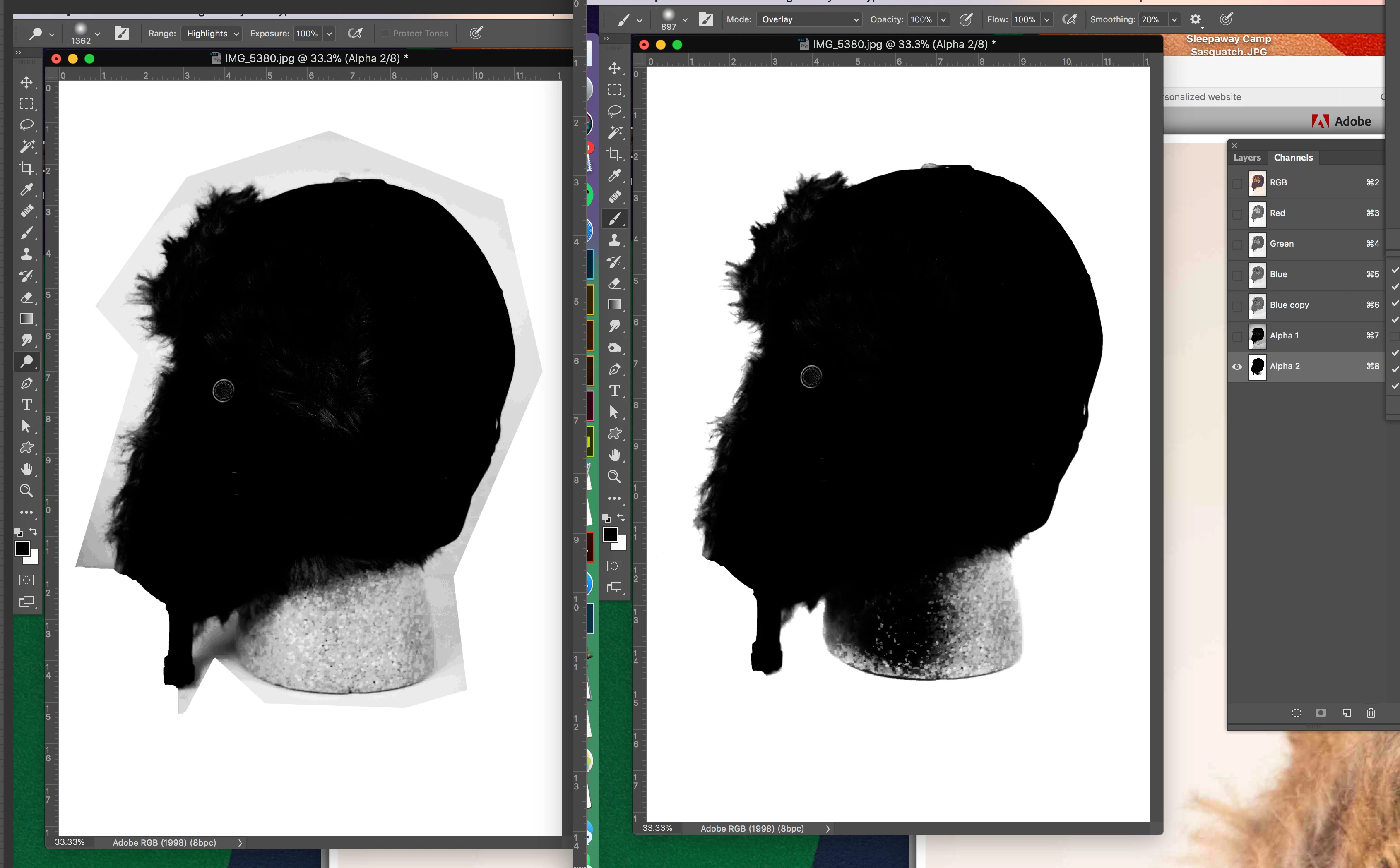

    After that I used the calculations command set to overlay to increase the difference between the lights and darks (its a contrast mode). It created a new channel which is the one I focused on from here on out (Alpha 2).

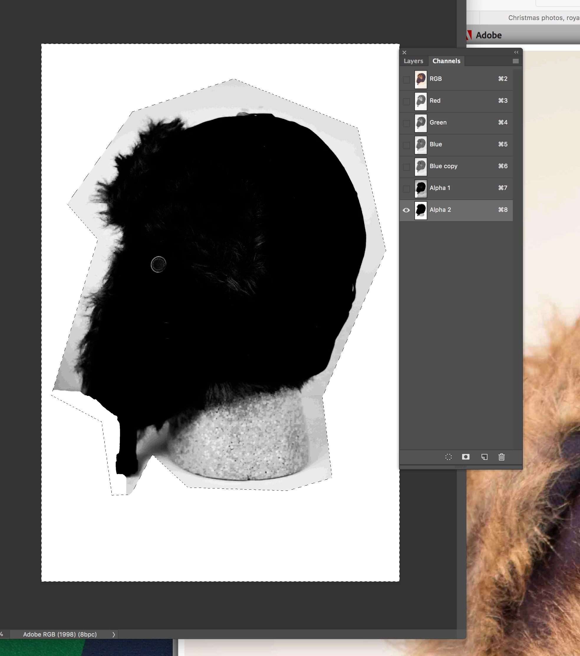

    With the lasso tool, I selected the most important area of the image. Then inverted it and filled it with white.
    With the Dodge tool set as you see, I was able to get rid of the highlight areas. With a black brush set to overlay, I filled in the darker areas.

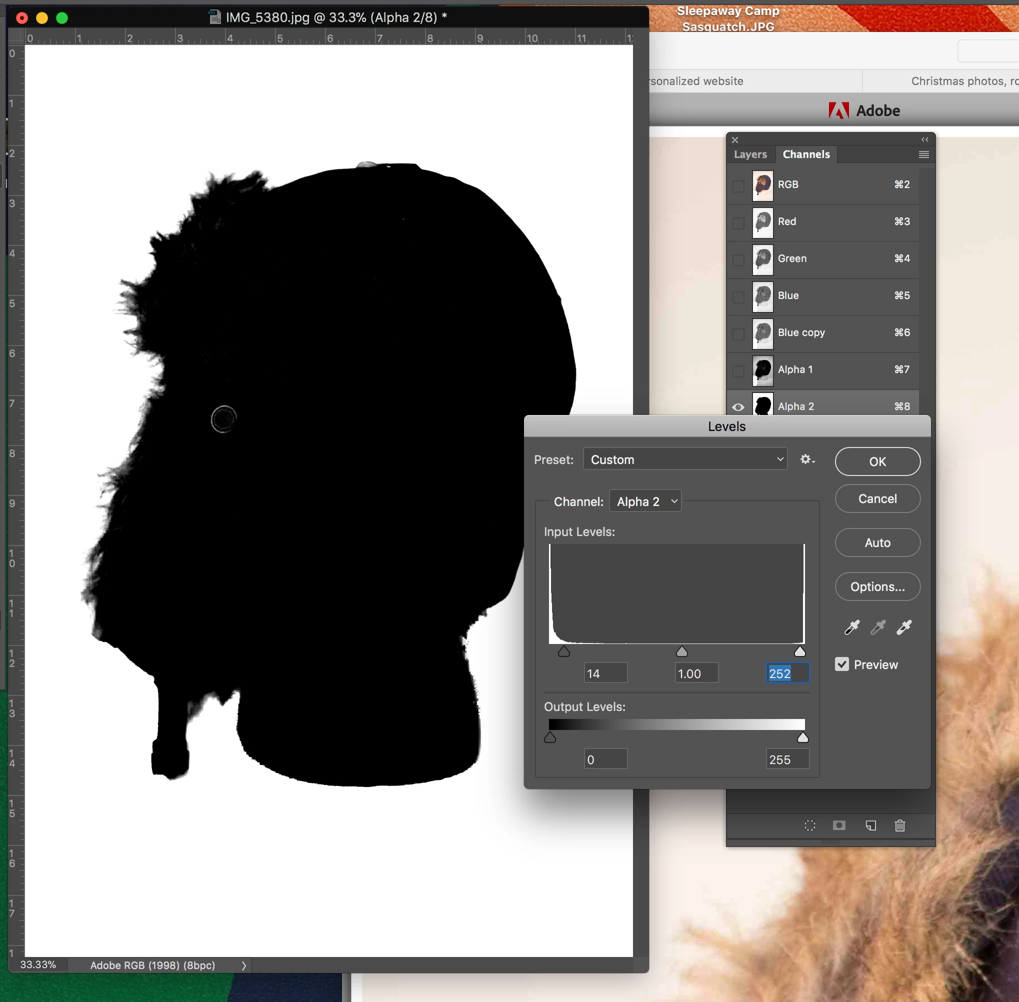

    Next I used levels to squash some of the grays. After hitting ok, I inverted the Alpha 2 channel with Command + I (Invert). I command clicked the Alpha 2 channel to make it a selection and clicked the mask button at the bottom of the layers palette.

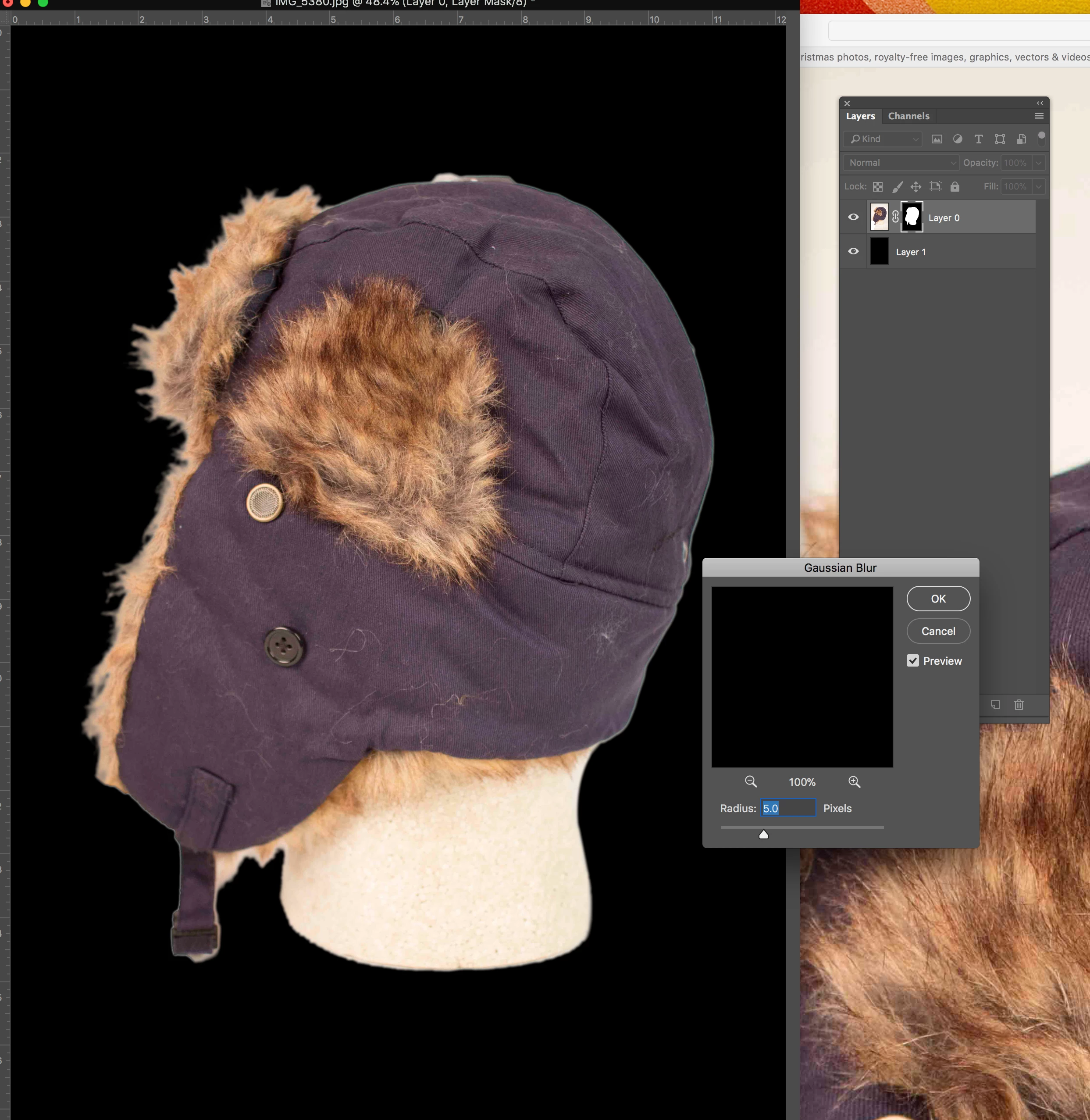

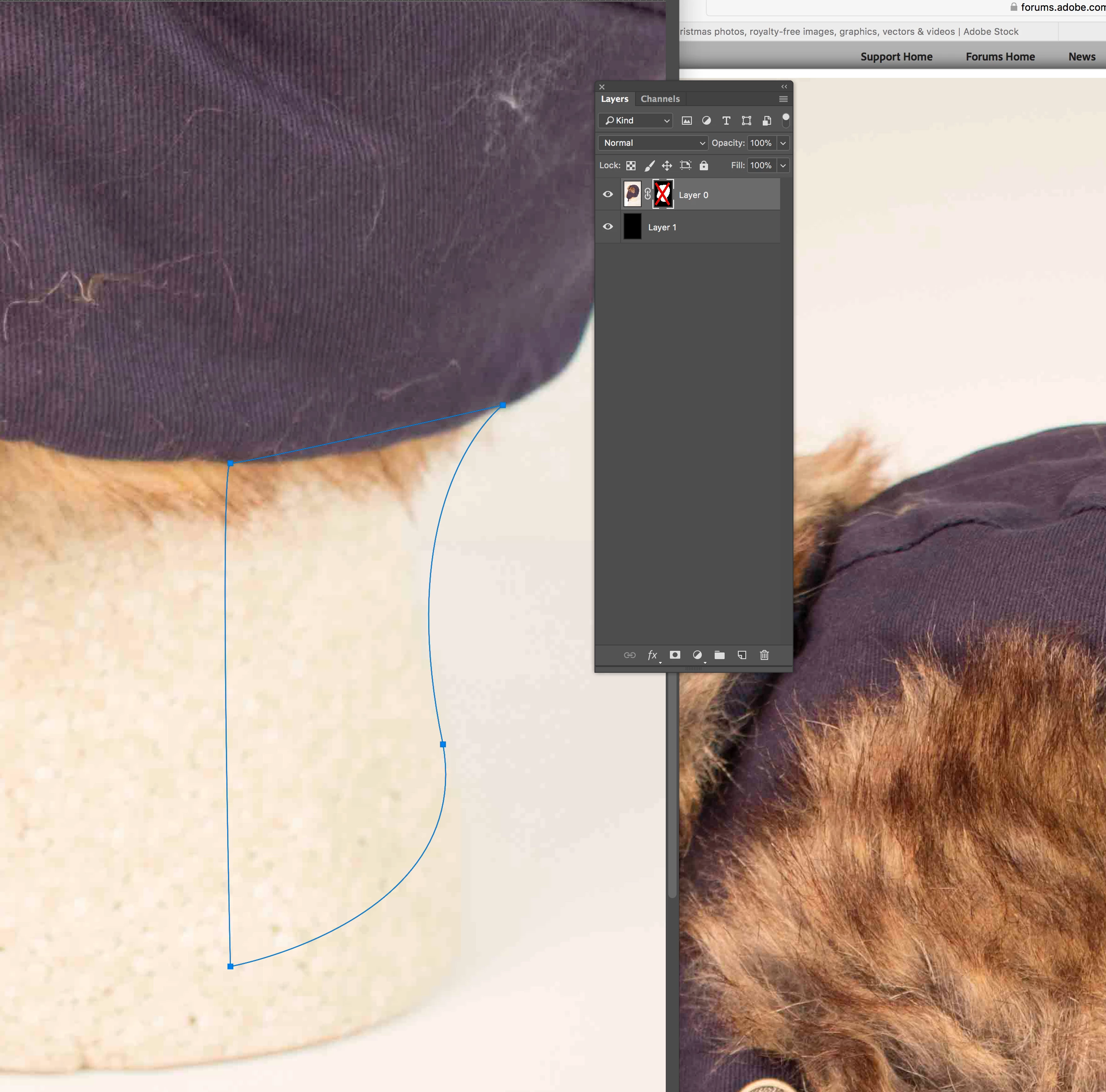

    There were some rough edges as you can see above. To soften those harsh edges on the back of the styrofoam neck, I used the pen tool to delicate trace a smooth transition on the mask. Command + clicking a path makes it a selection. I filled it with while. Remember, white reveals, black conceals.
    Once I had the mask there, to soften it I invoked the gaussian blur command.
    I then fade the blur with the fade command (command shift + f, immediately). I set the fade to multiply. It brings some of the contrast back into the mask.

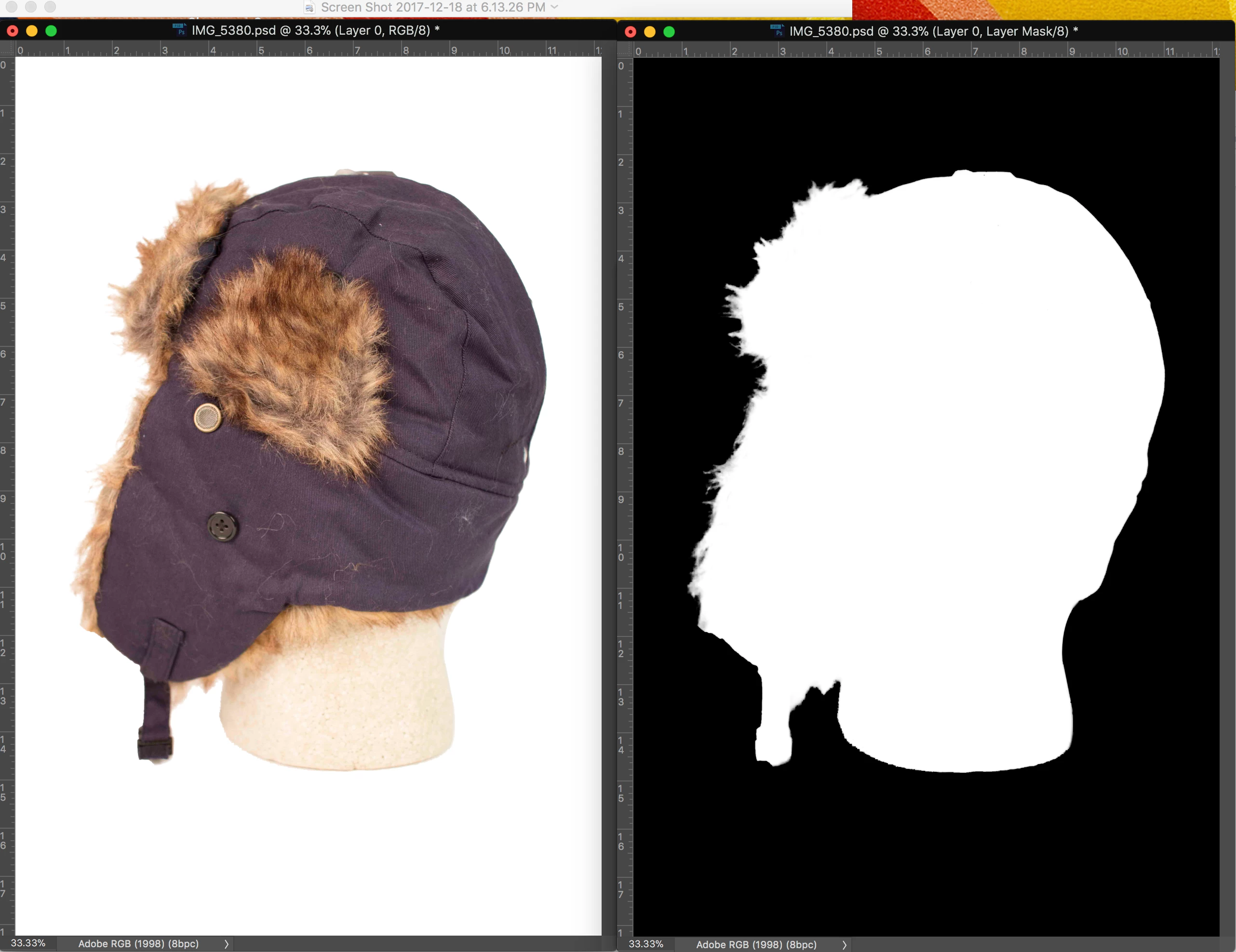

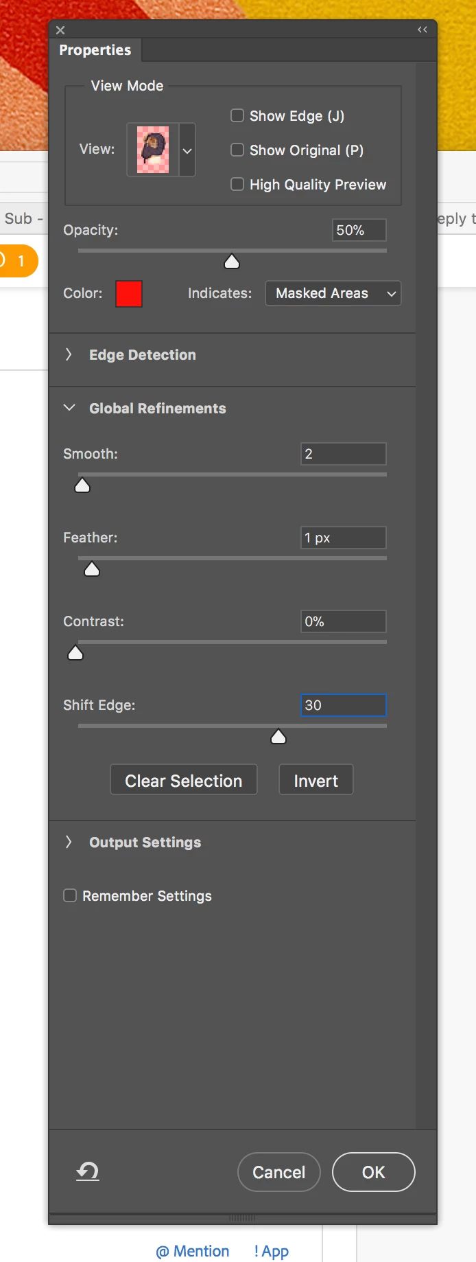

    You can further refine the mask by double-clicking it and using the refine mask command. I used roughly these values:

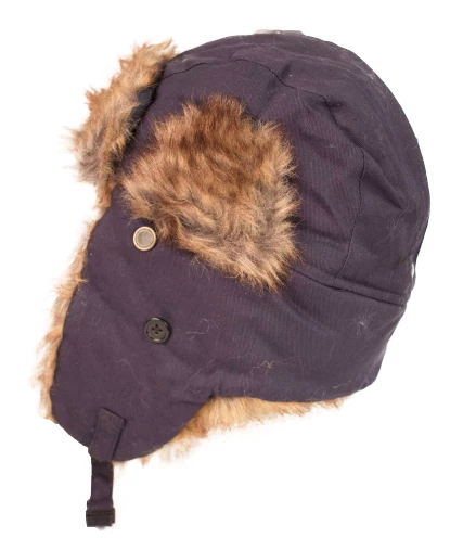

    And this is what I would up with:
    Here is the image masked and the mask itself. With fuzz and low contrast on the bottom, its not as easy as a selection tool. Channels usually (not always) have a mask hiding in them. Used in conjunction with calculations and a good overlay brush, those are your weapons for attacking fuzzy beasts like this. It took me longer to write this out than to actually do the task. I hope this helped! Cheers!

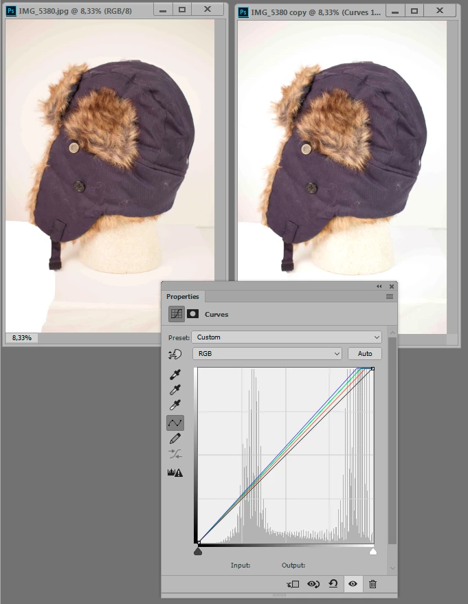

    Hi
    If you get the chance - rephotograph the hat with a better contrast between the fur and the background. If not you could try using a copy of the blue channel with a curves adjustment to make an initial mask.
    Then use a brush to ensure the centre is solid white and the select and mask refine edge tool on the fur edges
