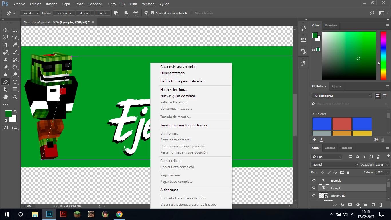

I need fill this part with feather tool:

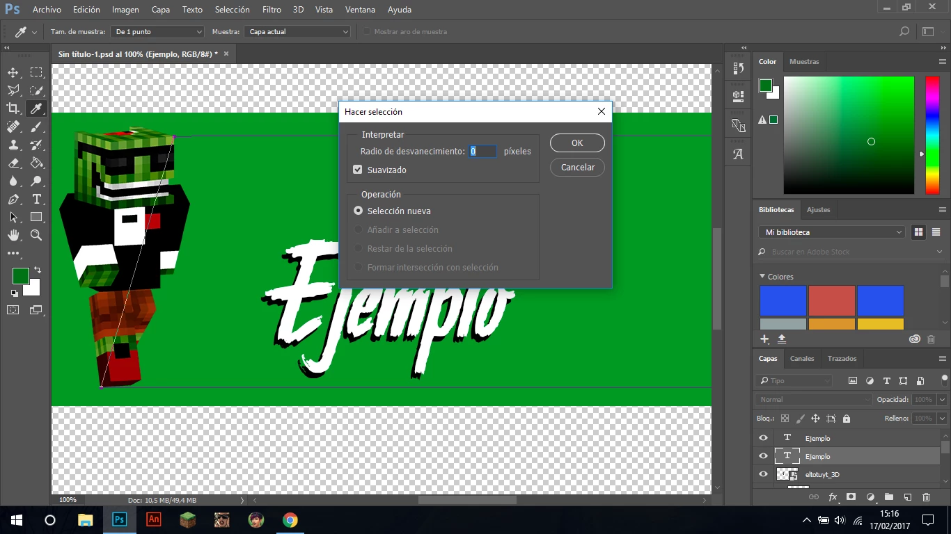

Okay, the next step is make selection:

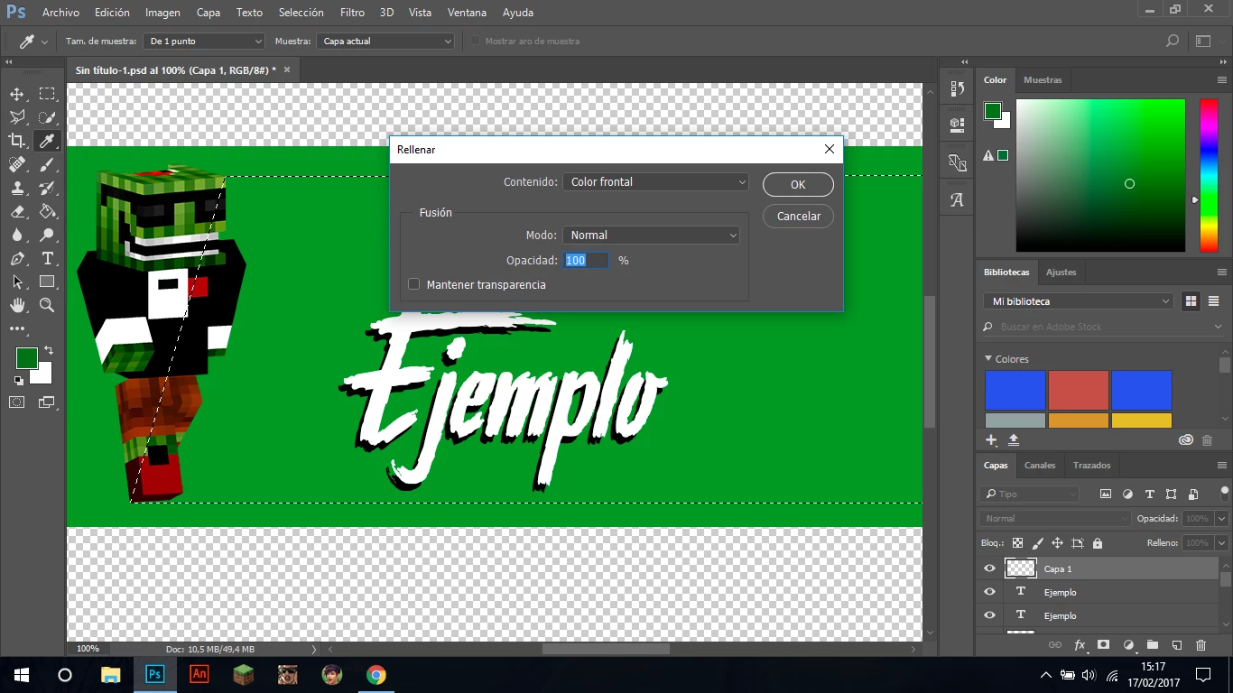

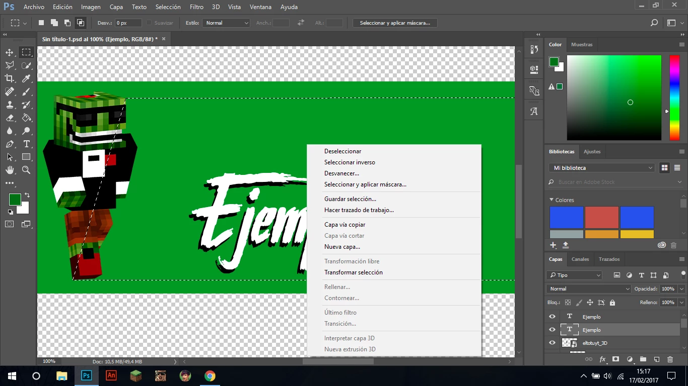

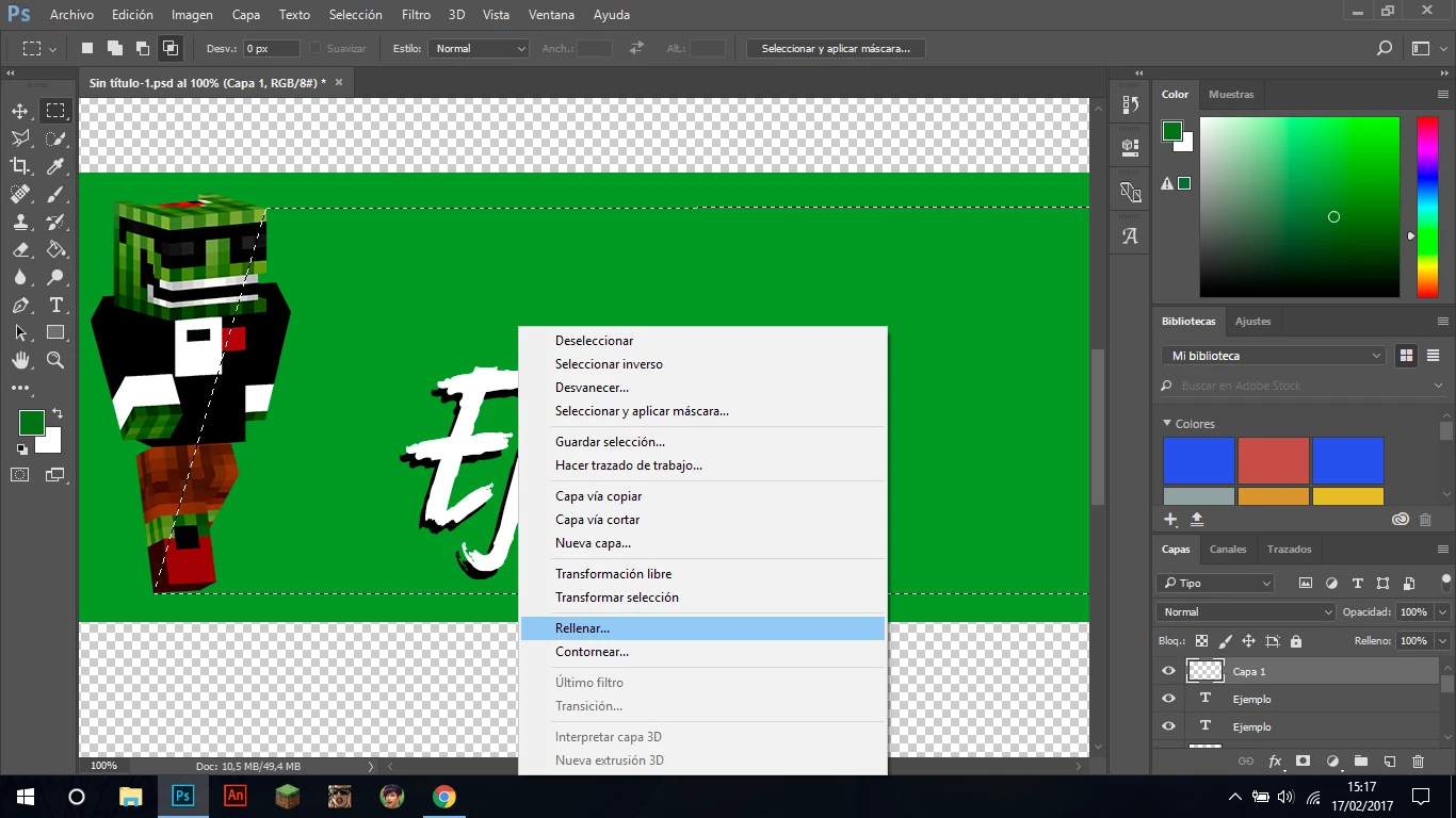

Okay, the next step is fill that selection:

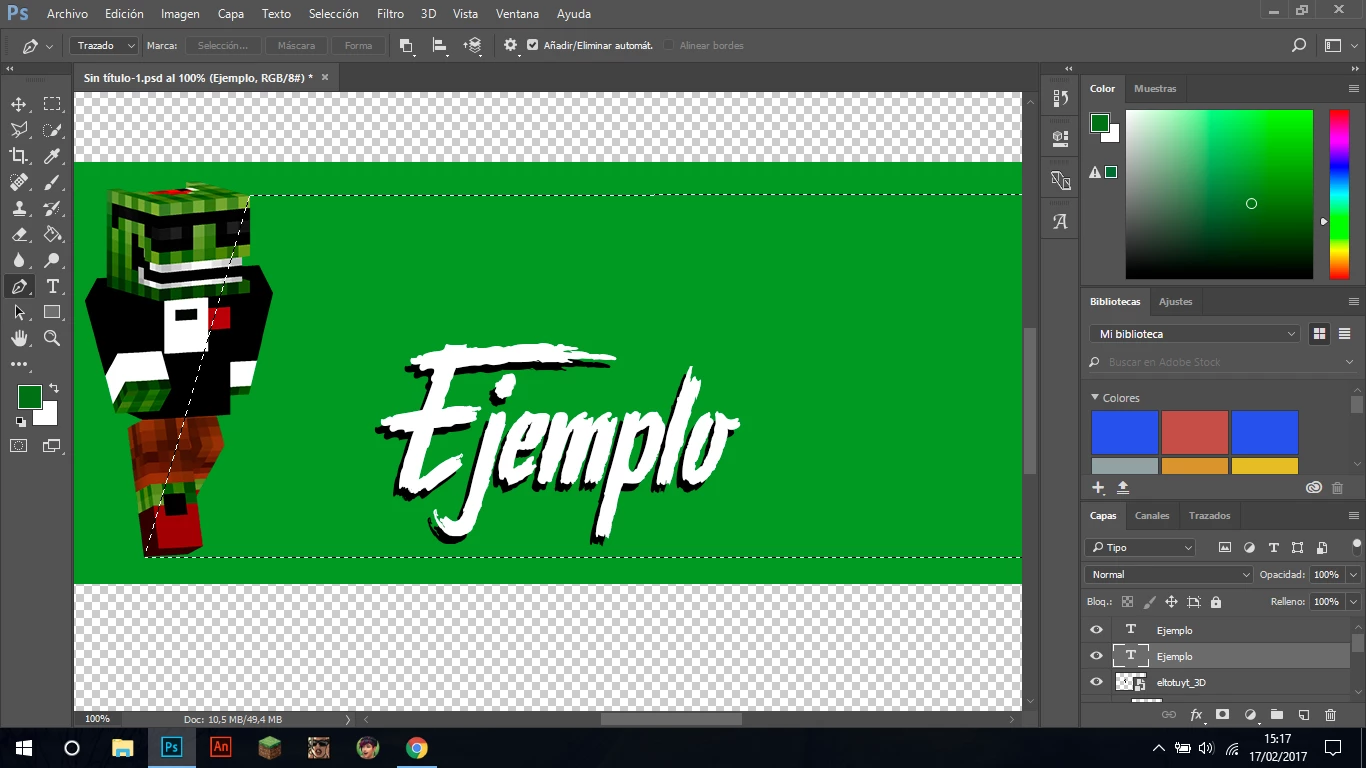

BUT HERE COMES THE ERROR
This is the error, the selection not filled 😕😕

It went wrong at the start, when you used the pen tool to create your path before turning it into a selected area. You had "subtract front shape" set in the options bar. So your selection excluded the area rather than containing it.
Change it to combine shapes if you do it again
Note : If you still have the selection you can invert it with Shift + Ctrl + I
Dave
