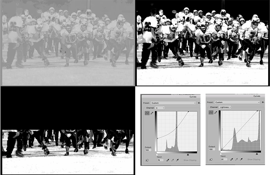

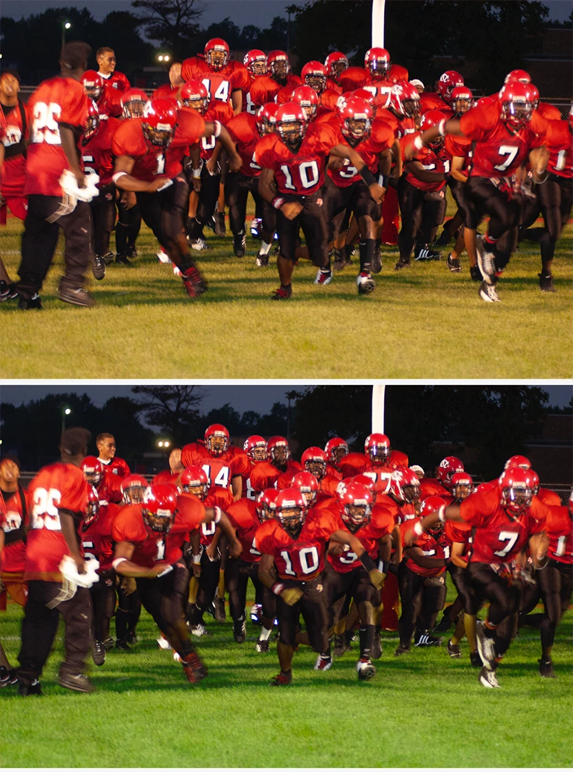

This solution to the color problem requires no brushwork, moves the turf color to the green seen at night games under lights (it is adjustable) and adds texture to the turf.
It is done completely in Lab Color mode.
You will use the b curve to create the mask, the a curve to adjust the color and the Lightness curve to increase the turf texture.
> Convert the Mode to Lab Color
> Add a duplicate of the image layer
> Create the mask:
     In the Channels panel make a duplicate of the b channel.(Fig 1)
     Use Curves to increase the contrast as shown (Fig 2 )
     Note where the turf ends, select the upper half of the image and make that black as well (Fig 3)
     Add the mask to the top Image layer in the Layers panel
> Correct the color:
     Choose the image in the top image layer, then choose Curves
     Adjust the a curve (which controls Magenta and Green) and adjust the Lightness curve as shown
> Return to RGB mode
