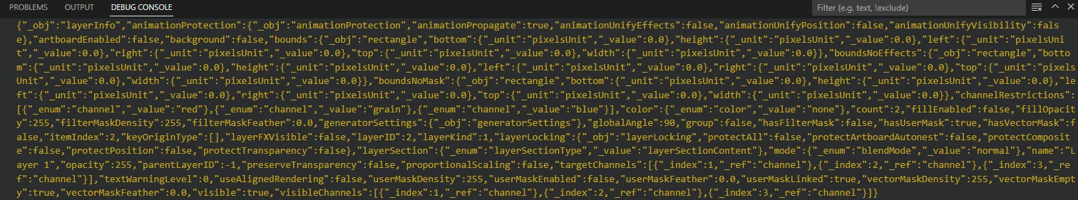

Next, we build on the example from ccx-start.jsx and add a function to convert ActionDescriptor to json (for convenience, we output information to the console):
s2t = stringIDToTypeID;
var r = new ActionReference();
r.putEnumerated(s2t('layer'), s2t('ordinal'), s2t('targetEnum'));
var d = new ActionDescriptor();
d.putObject(s2t('object'), s2t('layerInfo'), executeActionGet(r));
$.writeln(executeAction(s2t('convertJSONdescriptor'), d).getString(s2t('json')));
Result:
It works, but the json output goes on one line without formatting. We copy it and go to any online json beautifier, format our code and start looking for everything related to masks:
