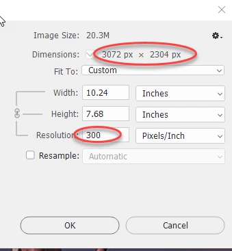

I am trying to get images set up for a relator I am editing for. The images are required to be at 4:3 ratio, 300 dpi, and at least 3072x2304. I want to set up an automated batch once I can figure out how to get all three completed. I can get the ratio and the dpi but it puts the image at 1200x900. Help, what do I do? I am on a deadline. I need to know how to up the resolution while making it that ratio and dpi. I am using the newest version of Photoshop CC.

    If your image is taken with only 1200x900 pixels then you would need to interpolate - but that does not add any detail at all it just adds "in between" pixels which will soften the image.
    This needs to be in three stages.
    1. Start with an image with more than/equal to 3072x2304 pixels.
    2. Crop it to the 4x3 ratio
    3. In Image >Image Size set the resolution to 300ppi without resampling (i.e. uncheck resample)
    If you do not have a starting image with the 3072x2304 pixel minimum then you can use Photoshop Image size to increase the number of image pixels (by checking resample and using Preserve Details 2.0 as the algorithm)  but you are not really meeting the requirements of the realtor. The the minimum pixel size is set to ensure that sufficient detail is contained in the image for its intended use. Using resample to interpolate pixels and create a larger size does not add detail. It just spreads existing detail over more pixels.
