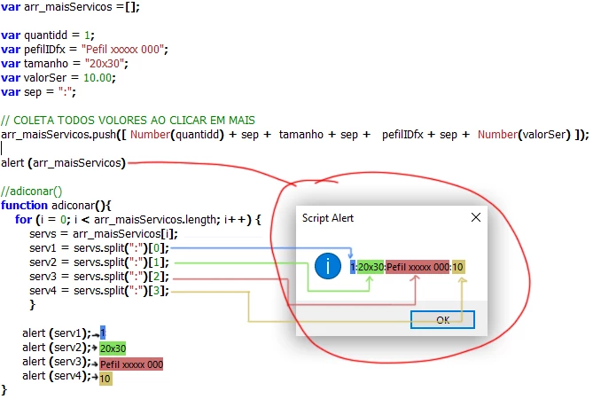

Guys, I'm new to scripts and I'm trying to store some values in series within each item of an array, however, I get an error when I use the "slice()" method to separate each value.
What am I doing wrong? Can anyone point me in some direction where I can solve this problem?
var arr_maisServicos =[];
var quantidd = 1;
var pefilIDfx = "Pefil xxxxx 000";
var tamanho = "20x30";
var valorSer = 10.00;
var sep = ":";
// COLETA TODOS VOLORES AO CLICAR EM MAIS
arr_maisServicos.push([ Number(quantidd) + sep +  tamanho + sep +   pefilIDfx + sep +  Number(valorSer) ]);
adiconar()
function adiconar(){
    for (i = 0; i < arr_maisServicos.length; i++) {
        servs = arr_maisServicos[i];
        serv1 = servs.split(":")[0];
        serv2 = servs.split(":")[1];
        serv3 = servs.split(":")[2];
        serv4 = servs.split(":")[3];
      alert (serv1);
      alert (serv2);
      alert (serv3);
      alert (serv4);
Correct answer c.pfaffenbichler
servs is an Array, so »split« does not apply, even though it contains only one String
Why did you add the squared brackets in the line

Hi @c.pfaffenbichler , thanks for replying. As I mentioned, I'm new to scripts, I started exploring arrays that will serve me a lot.
Square brackets on the line you refer to in your question are the square brackets? push( [xxxx ] ).
arr_maisServicos.push([ Number(quantidd) + sep + size + sep + profileIDfx + sep + Number(ValueSer) ]);
I don't know where I got this from, but I decided to remove "[ ]" and it worked perfectly.
it was like this:
arr_maisServicos.push( Number(quantidd) + sep + size + sep + profileIDfx + sep + Number(ValueSer));
Thank you, your question was the solution to the problem.
c.pfaffenbichler
August 7, 2022
The method »split« is for Strings, Arrays are already collections of separate »objects« (edit: like Strings, Integers, Booleans, Arrays, …).
I was talking about the square brackets (»[« and »]«) by which you needlessly wrapped a String into an Array which you then pushed into another Array.
