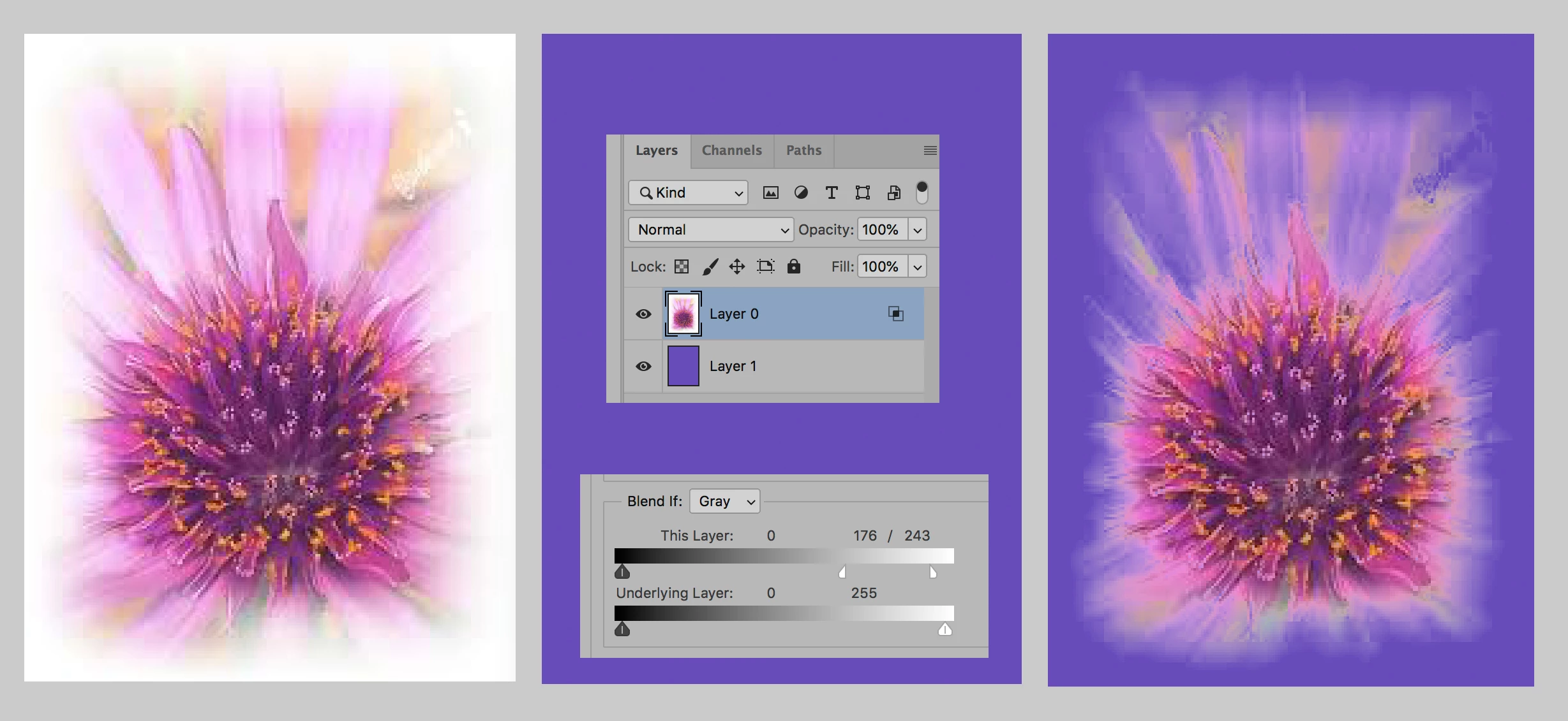

I found this random sample image via Google. When used as shown above, it has full value colors and a vignette extended into a darker background, something akin to your art, judging from your description. The result may be merged down into one layer.
For this effect, the Blend If command is used as shown. By using the Option key, and clicking and dragging the left side of the top right marker you control the degree of vignette into the darker panel.
This approach may be adaptable to your project.
