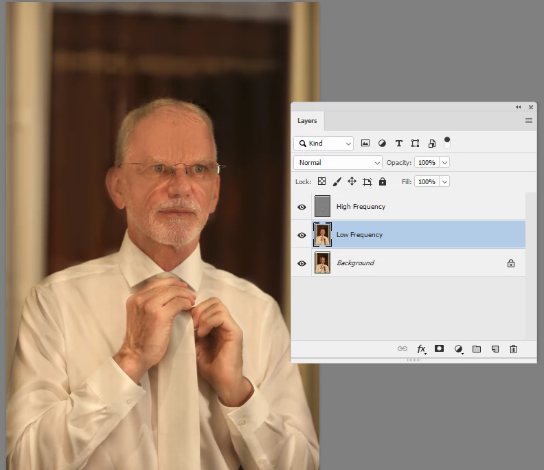

December 10, 2018
Hi
Try frequency separation (as per the other linked post)
Make two copies of the image layer.
Name the lower "Low Frequency"
Name the upper "High Frequency"
Select the low frequency and apply a  gaussian blur of around 6px
Select the high frequency layer and goto menu Image - Apply Image
Set the layer to use as "Low Frequency"
Set Blending mode to subtract
Scale 2
Offset 128
Click OK
Set High Frequency layer blending mode to Linear Light
Now, on the low frequency layer, paint with a soft, low opacity brush, over the banding using colour from other parts of the image
