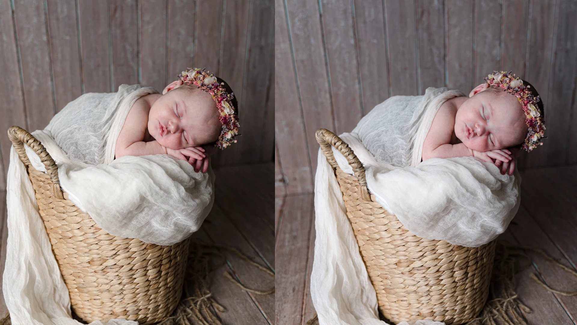

Hi all, wondering if someone can explain what is going on here... I have recently installed photoshop onto a new computer and the presets i use are coming out completely wrong on it. I have tried calibrating the screen etc but i think theres something going on with the colour profiles or something within Adobe..
- I have uninstalled and reinstalled everything.
- The new computer has a fresh install of windows
- I have checked all the settings in the preset profile to ensure they match on both computers.
- all adobe settings and camera raw settings match on both
- Re-installed and downloaded presets multiple times
- Installed photoshop onto a 3rd computer and it works fine as intended
I thought it might be monitor calibration but after exporting on both computers they export differently, if it was a monitor issue then exporting on both computers with exact same settings should look identical, should they not?

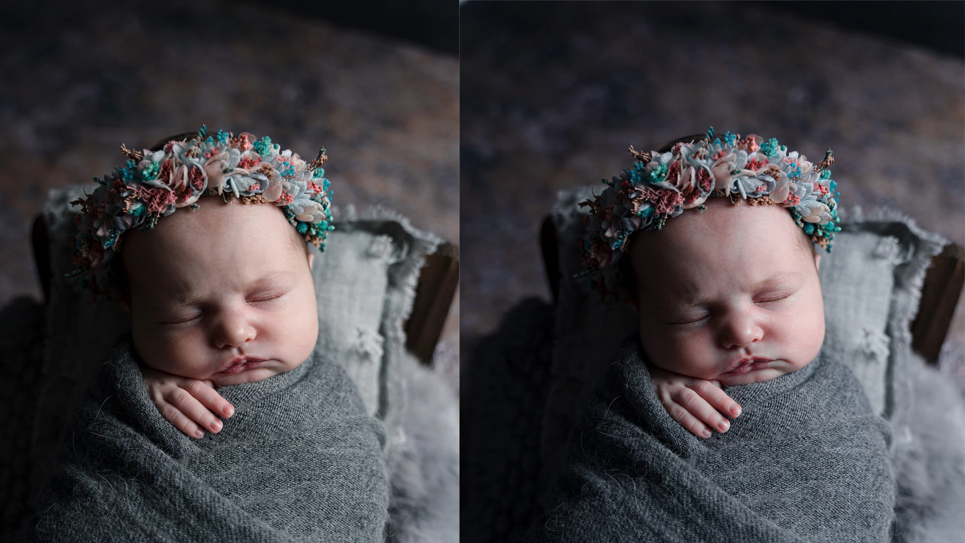

Below is a couple test images, fresh RAW files with only 1 preset installed no other modifying... as you can see on the photos on the right its quite blue around the eyes/upper lip/ bridge of nose/ fingers.. anyway.. any ideas what could be causing this? m plling m hair out at this stage.. 😞
Any help would be greatly appreciated.
Chris

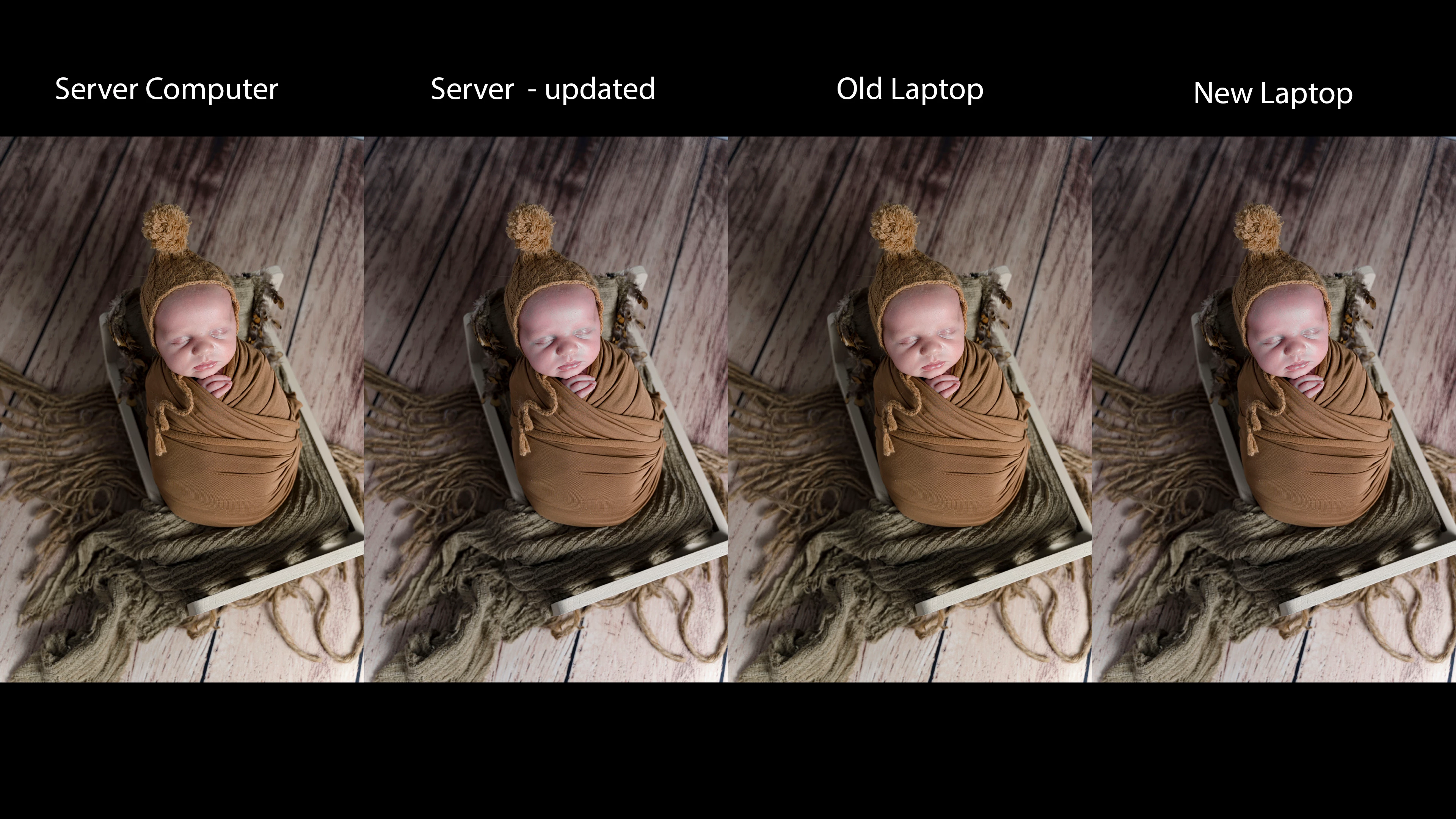

OK i have figured it out.. Short answer.. Photoshop update! WHY?!
So after numerous testing and head scratching this is what i have found..
Old Laptop - Presets look good and how they're suppose to
2nd Laptop (fresh install/reformat) - Bad
Server Computer - Good (exactly the same as old laptop)
Brand new laptop - Bad
It got me thinking.. what do these all have in common with one another.. The old laptop and server havent updated photoshop in months.. the other 2 had fresh installs with latest builds.. so i hesitantly updated my server computer to latest photoshop knowing if i'm right i can't go back.. and bam! there we have it, colours have all gone to crap. Now this is a little annoying to say the least as you can't exactly roll back versions of photoshop. What could they have possibly done that would make photoshop interpret these things differently. could it be a bug of some sort that can be reported? how do you go about such a thing? Or do we just have to live with it?
Attached is a 4 way comparison.. If you zoom in you can clearly see the extra red in the face and blue around the eyes from the latest version of photoshop..

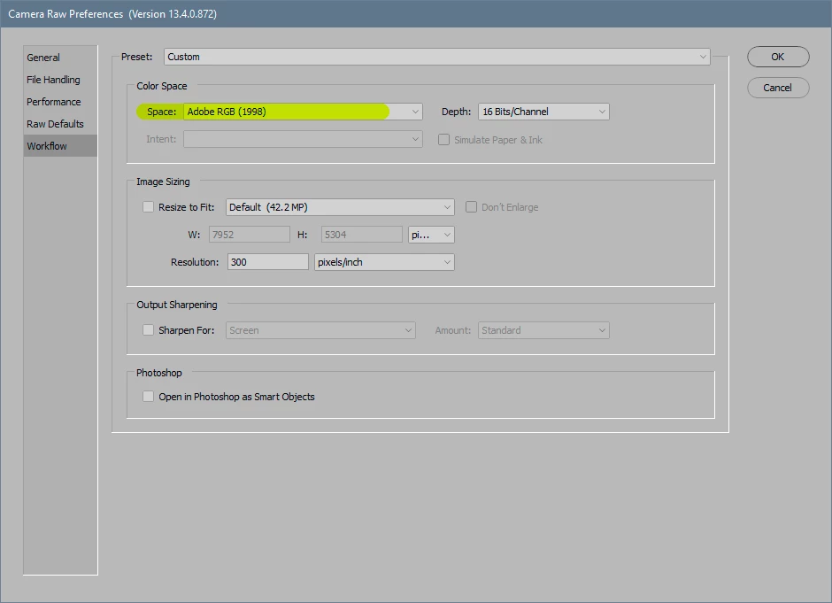

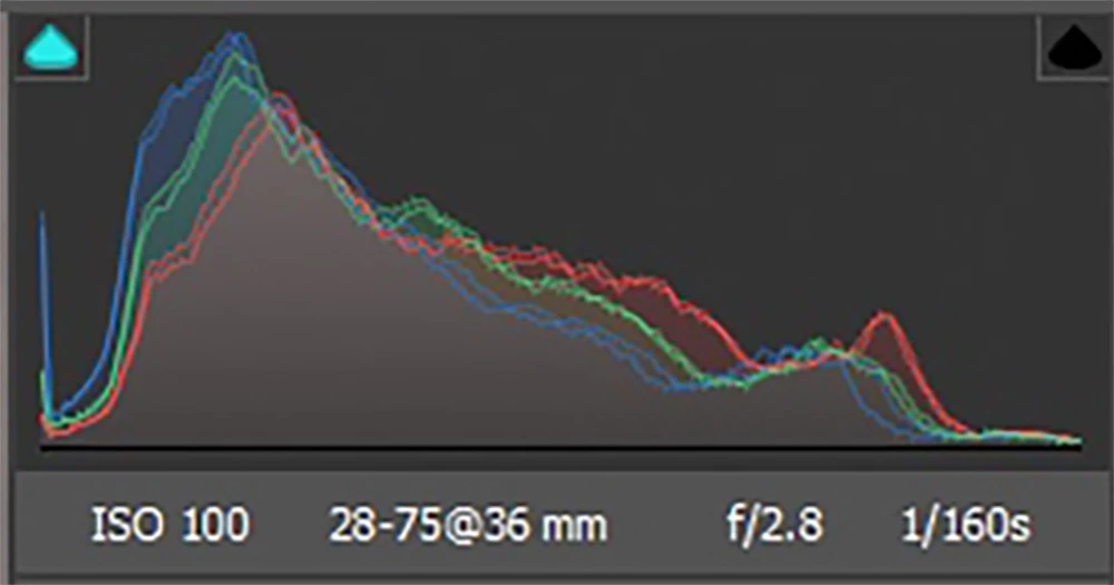

One thing i have noticed is in camera raw histagram, they dont match quite 100%. why would that be? both set to defaults (adobe rgb, 8bit color space - raw defaults on adobe default etc) plus all the colour settings in photoshop set to the default (North america general purpose 2).. but if i overlay them you can see some differences. I'm assuming whatever is causing the difference there is why they export different.. That is using exact same 'preset' on a raw file with no other tweaking done. I have also confirmed the values in the "Edit" section like Basic,curve, details, colour mixer, colour grading etc are all identical and match..

To be clear, are these presets Photoshop adjustments, performed on an open file in Photoshop? They're not Camera Raw presets?
If so, the explanation is most likely that your files are in different color spaces. A numerical adjustment is color space specific. It will produce different results in sRGB or Adobe RGB or ProPhoto.
The working space you have set in Color Settings is just a fallback default. The embedded document profile will always override it. And in the case of raw files coming from ACR, the color space is determined by your workflow settings in ACR. If it's set to open your files into ProPhoto, it will be a ProPhoto file in Photoshop even if your working space is sRGB.
September 23, 2021
Hey Thanks for the reply. No, not in Photoshop but in Camera RAW. For instance if i open a RAW photo, it opens Camera Raw, i select a preset and it instantly looks off.. before i even click open to load it into photoshop i will just hit Ctrl+S and export that image from ACR with the preset on and thats what it looks like, even when i load it into photoshop it makes no difference. I have checked the colour space and all other settings in Camera Raw on both systems and they're both the same. I just checked this afternoon and the presets are doing the same thing when i try and use Lightroom.. its like Adobe on this computer is interperating the presets or colour science totally different to my other computers.. even though all the settings seem to match?? It's so bloody weird.. I'm almost ready to reformat again because it's making no sense.
Another thing i tried.. was after loading the image, applying preset and saving it. I then took that RAW photo and the XMP profile created and loaded it onto the other computer in ACR and it loaded up with the same preset based on the XMP and it looks correct. but i export from both computers and they turn out totally different. hmmm
