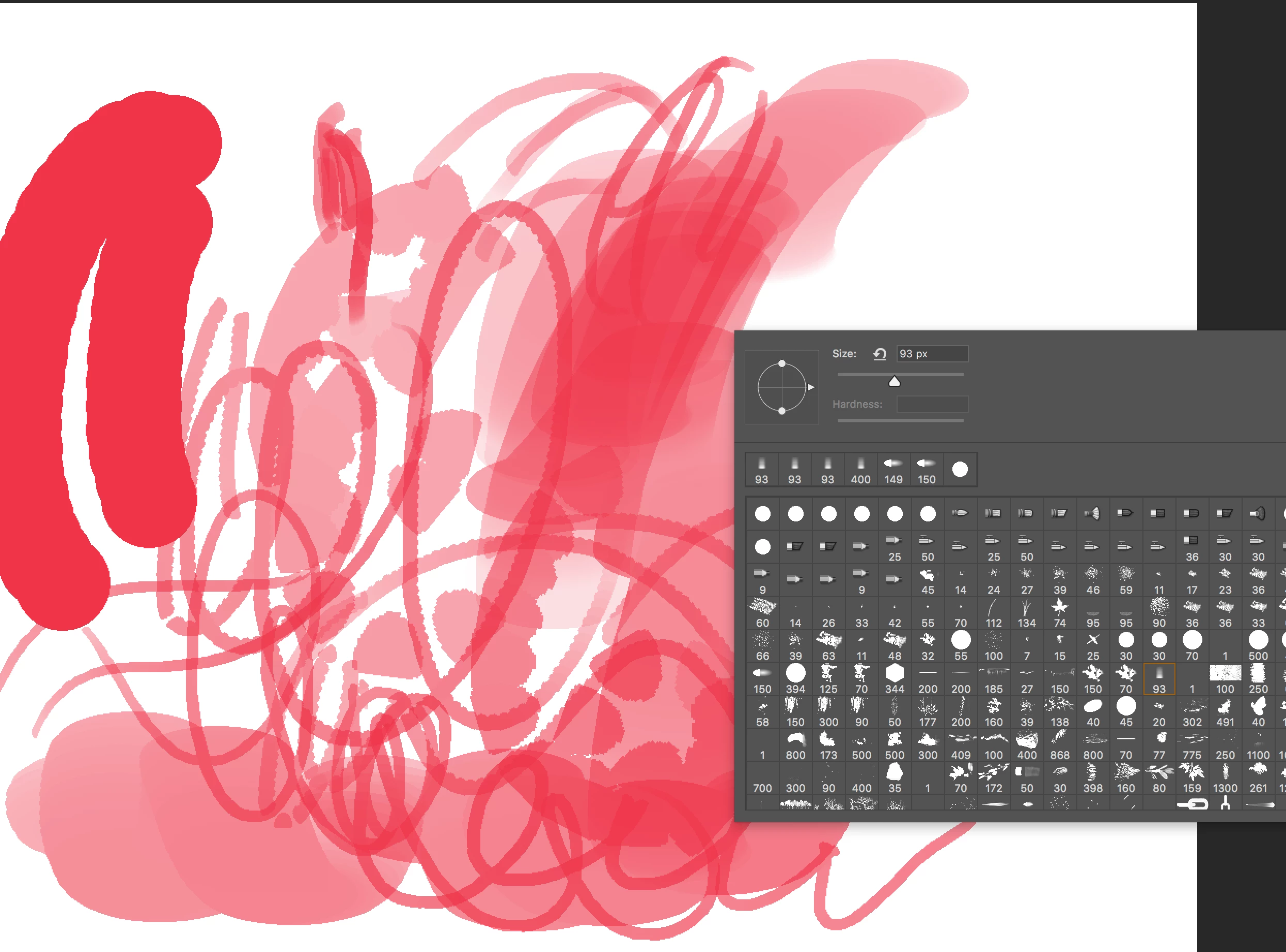

Hi everyone,
Most of time I use PTS is ok, but I do not know why, sometimes Soft brush in Brushes did not work. It can not paint blur. You can see in picture, soft brushes are disappeared.
Even I tried to reset my Mac, reset Wacom, update new Wacom softwave, .. but I noticed that in another softwave (ex: Clip Paint) I still can use soft brush like normal, but in PTS it did not. So maybe this problem belongs to PTS.
My painting has another painting softwave, but I feel more comfortable with PTS, but now this problem
Somebody have solutions please help me give it a try. I'm very grateful for your help.

papin_bread
July 9, 2018
Ohh, after reset Preferences my soft brush is work again! Thank you so much C.pfaffenbichler!!

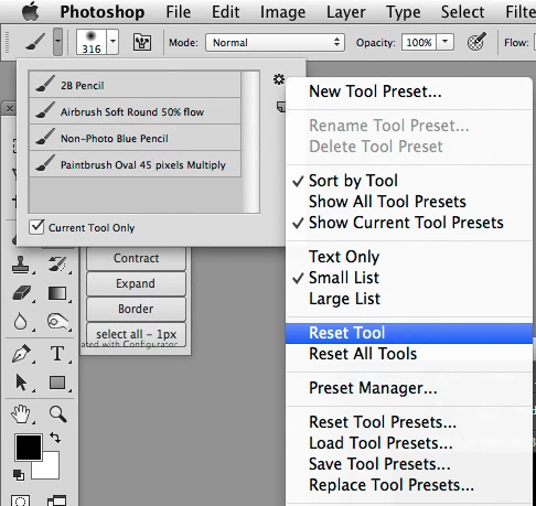

Should the issue arise again you could alternatively try the less drastic option of resetting only the affected Tool.
