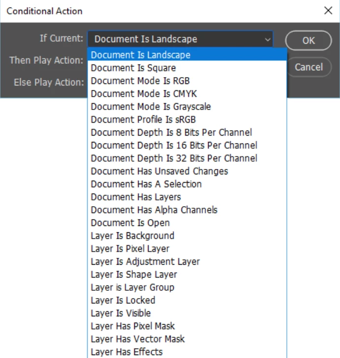

IMO the answer is simple.  It most likely not possible to do what you want to do in an action where things can differ in size.  Actions can use very little logic just test a few conditions.  They can not use  logic to deal with different sizes other to doing some things relative to document size using Photoshop ruler units set to percent.  Other ruler units like inches is relative to document dpi resolution and ruler  pixels is an absolute number of pixels. All steps are hard coded or made interactive.  You need to look into scripting what you want to do. Scripting can use logic to deal with size. Actions can only have some conditional steps.
In an action you can centers a layer center point over a pixel point. But a pixel point has two components not a single value like you write  there is a x and y offset from the document top left corner  0x, 0y point,  So if the layer is the right size and  no mater why its size is you want it center over a point in at document that is alwayr the same size you can do that in an action.
