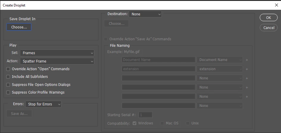

The idea is to then convert the action into a droplet and have the option to start in LR, hit batch droplet, boom, everything is done, all images are right there, nothing to do.
I do think making a droplet using your action  will work the way you envision.  If no Adobe application is running and you drop a file on a droplet you created in Photoshop. The droplet executable will start Photoshop and Pass the files to Photoshop to play the action recorded into the droplet by Photoshop when you create the droplet. I see no start in Lightroom in Photoshop Create droplet.  Can You create Droplets in Lightroom where Lightroom  passes file to Photoshop to play Actions you recorded in Photoshop?. I do not know Lightroom In can use Photoshop well.
