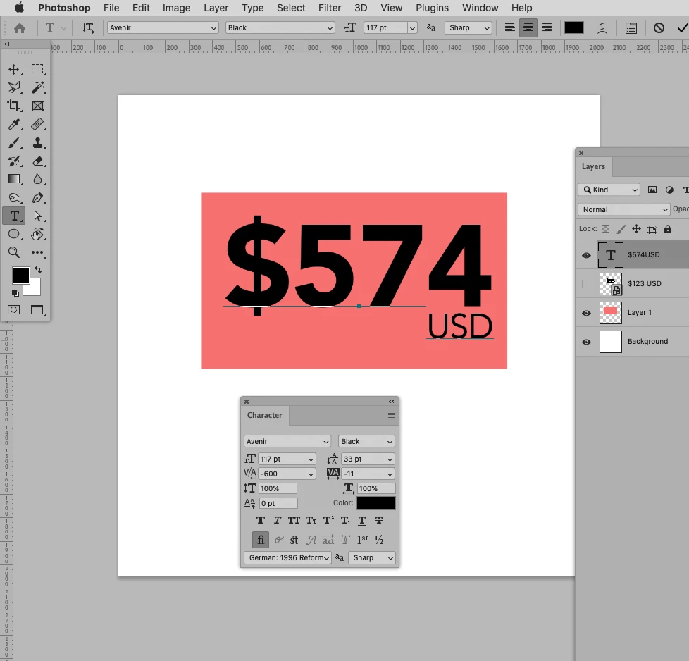

Another option might be using Baseline Shift and Kerning.
But one may have to re-apply the kerning if one has to change the the rightmost number, too.

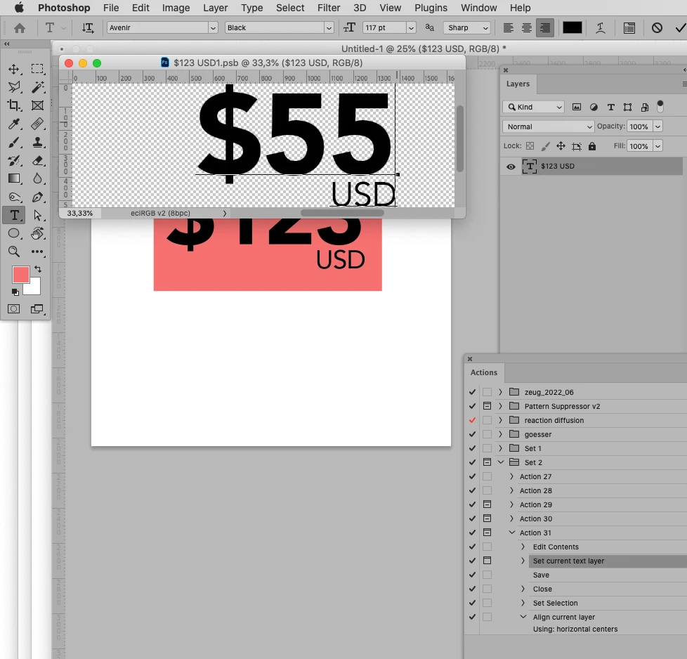

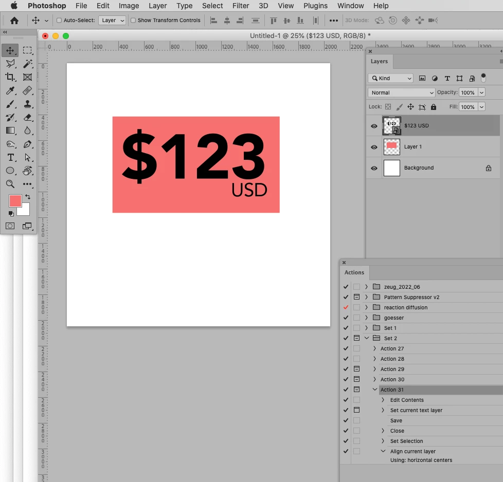

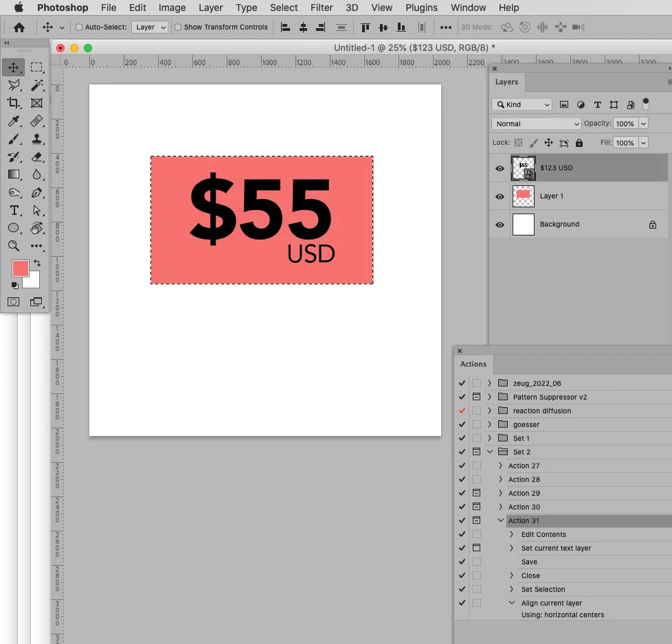

You can use an Action to automate the task.

Mylenium
November 16, 2022
That would be easy in InDesign, so you should consider doing it there. Otherwise I'd simply create a bunch of "prototype" layers with the alignment already in place and duplicate those as needed.

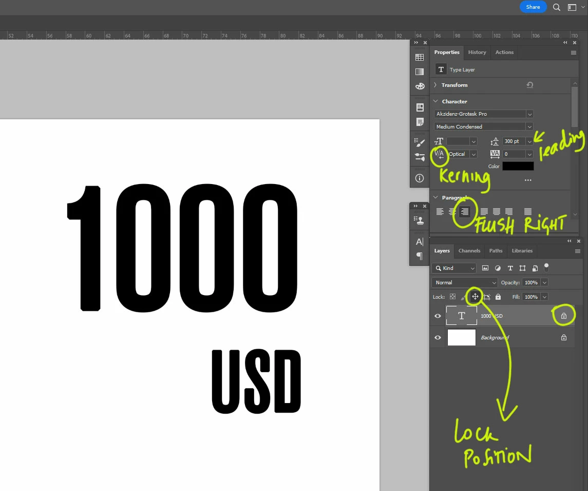

The way I would do it, is:
Create a new text layer where you'll type the price , soft return, then the currency
Flush right,
Change the size of the currency text to your liking alongside the leading which will be by default too too (since text sizes are different)
Lock the position of the text layer (only the position obviously, but not mandatory) in the layers panel.
When you'll change the price, the text will not move and just extend on the left if the figure is bigger. (since you flushed right)
Locking the positionning of the layer will also allow not to be accidentally moved while typing.
While you're typing your text:
Check leading and kerning so the text seems right for all text lengh (Everything can be found in the properties panel, no messing in a thousand menus, productivity first!)
If you really have to do it lots (eg: as in "for a living", it may be beneficial you have a look at variables in Photoshop.
https://helpx.adobe.com/uk/photoshop/using/creating-data-driven-graphics.html
(not the simplest thing, but again... Productivity!)
