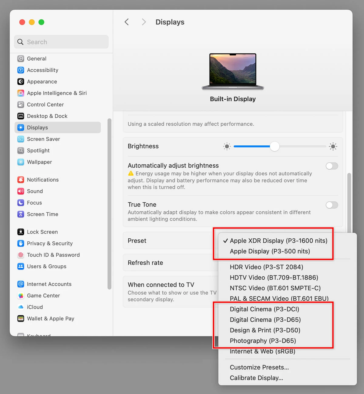

Because you mentioned a MacBook Pro, P3, and D50, are you actually asking about the P3 Presets in System Settings / Displays, and not about profiles in Photoshop? If so, are you asking about the P3 presets I marked in the picture below?
If that’s what you’re asking about, this is an area widely misunderstood by many Mac users because it’s relatively new. Those are definitely not profiles and should never be called profiles, to avoid confusion with the ICC color profiles used for display, editing, and printing. These are reference mode Presets and are an entirely different kind of thing altogether. And they do not replace ICC profiles, but work together with them.
This is what they are for:
Design & Print (P3-D50) and Photography (P3-D65) can be appropriate for print, because of their maximum luminance of 160 nits. Choose the one with the white point that your printing company tells you is a closer match to their viewing booth for print proofing. But I think a lower display luminance is more appropriate for print, so I used the Customize Presets command to copy one and lower its Maximum Luminance to where I like it.
Apple XDR Display (P3 - 1600 nits): This is best for viewing and editing HDR photos/video. Not recommended for previewing for print, because the dynamic range vastly exceeds what any printer ever made can reproduce.
Apple Display (P3 - 500 nits): This is kind of OK for print if you’re fine with a D65 white point, but the maximum luminance is a bit bright for print. If you dial it down to around 90-120 nits using the Brightness controls, that would work a little better for print.
Digital Cinema (P3-DCI) and (P3-D65) should only be used for editing video to be shown in cinemas because of the extremely low maximum luminance of 48 nits, which is how dim it can be in a movie theatre. The only difference between these two is the white point.
Reference mode presets are not some kind of weird Apple thing. They are similar to the hardware calibration presets that have been in use in high-end displays for many years. They constrain the hardware behavior of the display from its native calibrated state, unlike an ICC color display profile that the operating system uses to apply a calibration in software.
P3 will work fine for general process color print reproduction. Some will prefer Adobe RGB because that fits CMYK slightly better, but if you’ll be editing on your MacBook Pro display, Apple display panels are natively P3.
