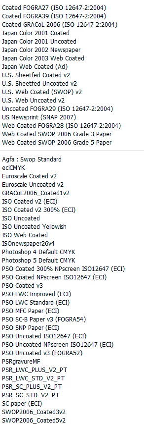

A CMYK profile specifies and describes a certain print process - an offset press calibrated to a certain standard, using certain inks on certain paper stock. This is all defined in the icc profile.
When you know which CMYK profile to use, make a copy of the file. Then you can soft proof to the CMYK profile, to see what colors are out of gamut and not printable. You set this up in View > Proof Setup. Based on that, you may want to make adjustments to compensate. Or not.
Then you can make the final conversion to CMYK and send that.
(some of these are outdated/obsolete and not used anymore, so in practice the list is a bit shorter)
