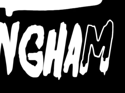

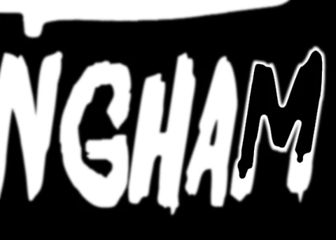

Okay, So I am making images to put on shirts. They are simple white images for black shirts. I looked up a simple way to make all my jagged and otherwise messy lines smooth. I have been 1) flattening 2) adding a blur 3) using the Create new fill or Adjustment layer button, selecting Curves and playing with he handles until I have a sharp clean edge. It looks great, perfect. BUT when I remove the bottom black layer to make a PNG it looks blurry again. Then when I upload the PNG it is blurry once again. IS there a way to make the crisp adjustment layer stay with the png when it exports?  Thank you in advance.
My finished product with the adjustment layer before I export:
After I export as a PNG:

    You say "after exporting a PNG". I'm guessing you didn't just open the PNG back in Photoshop. Please do that. How does it look? Now, what DID you do to get that screen shot? My first guess is that you uploaded it to some web site and then looked at what was on screen.

    Hello! Thank you for your reply. I have done both Save As png and Export > Quick Export PNG. The first shot is of the work with the black background in place. I then remove the black background, save as a PNG. The I re opened the PNG file into the same photoshop project and turned the black layer back on. I then took screen shots with the shift control 4 option on the mac.
