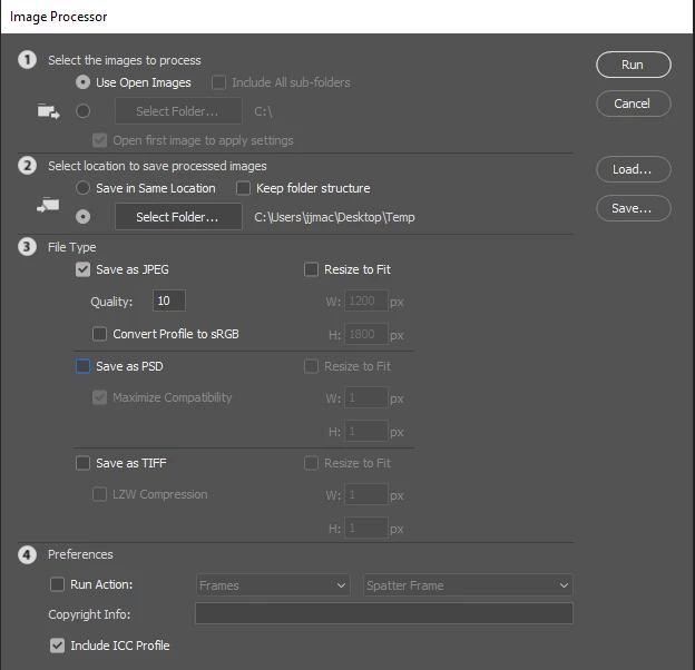

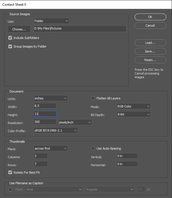

If all the Image files are all the same size or the same aspect ratio and has the same orientation landscape or portrait.  Why doe you not create a template file that has 3 columns and 7 rows.  And batch populate all your images into  that template in a single run.Free Photoshop Photo Collage and Mockup Toolkit
With Contact sheet II you should also be able to batch all you images into contact sheets that have 3 columns 7 rows of images  The images will retain the Aspect ratios so all the contact sheets may not have he same layout spacing.  All the Contact sheets will remain open in Photoshop which  you should be able to save using Imager Processor
