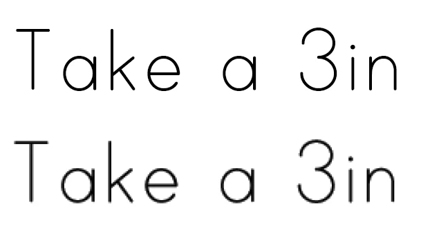

I am in the process taking an existing PDF into Photoshop, converting it to greyscale, and then re-saving it as a pdf. when I do this I am loosing a lot of resolution on the image, which is particularly obvious on the text in the attached image.
I am saving the pdf as a high quality print. I think all the other settings are just set to default is there something I am doing wrong?
Top text is the original document, bottom text is the re-saved document - only change is converting it to greyscale, but even if I change nothing and just save it I get the same result (the text is blown up to 600% on both)
BTW this is not an Anti-Alias issue on the text as the text is an imge not actual text

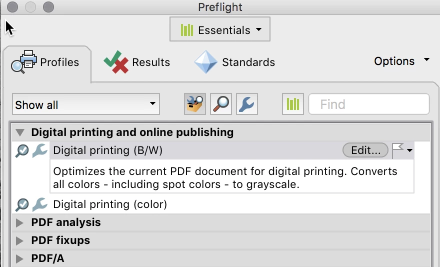

"converting it to greyscale, and then re-saving it as a pdf" 
If all you need to do is to convert your PDF to grayscale, would it work to bypass Photoshop and use the Preflight tool in Adobe Acrobat to convert the PDF to grayscale and save it as a copy?
~ Jane

I believe this is the key: (the text is blown up to 600% on both)
In the first example you have vector data in PDF while second example or resaved raster image is awful or pixelated because 600% enlargement. When you have vector data you can enlarge or zoom as much as you want and always to see beautiful text because vector data are used what mens everything is recalculated and displayed nicely. When you have raster image then zooming in will actually force software to quickly create new image based on fixed size raster image what will cause pixelation with larger zoom amount like 600% in your case.

If the text is indeed type in the pdf then converting the pdf in Photoshop and saving a pdf of that will degrade the output quality.
A halftone image, even if it were 1200ppi, will output as a halftome image and subsequently the black text, for example, would lose its sharp edges and instead be affected by the halftone screen.
