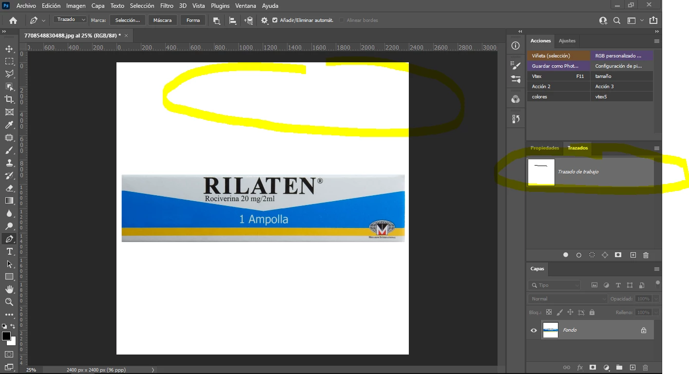

Hola, tengo un problema con la pluma ya que no me marca los puntos donde inicia y tampo me muestra el trasado, alguien sabe algo sobre esto, gracias.

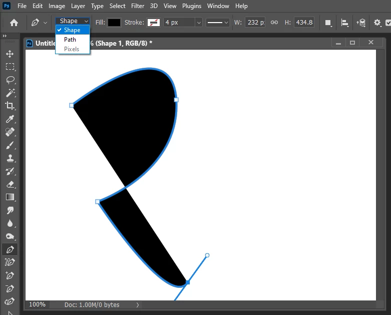

It look like you are using the Pen tool in Path mode. What problem do you have? The default color of the rubber Band lines is blue. In pah model Pixels are not added toe any layer. Paths are mathematical vector descriptions of paths you create with vector tools. You can add Path to layer as vector layer mask also strokes the paths on a layer with a Photoshop tool that follows the path.
The pen tool can also be used in Shape mode

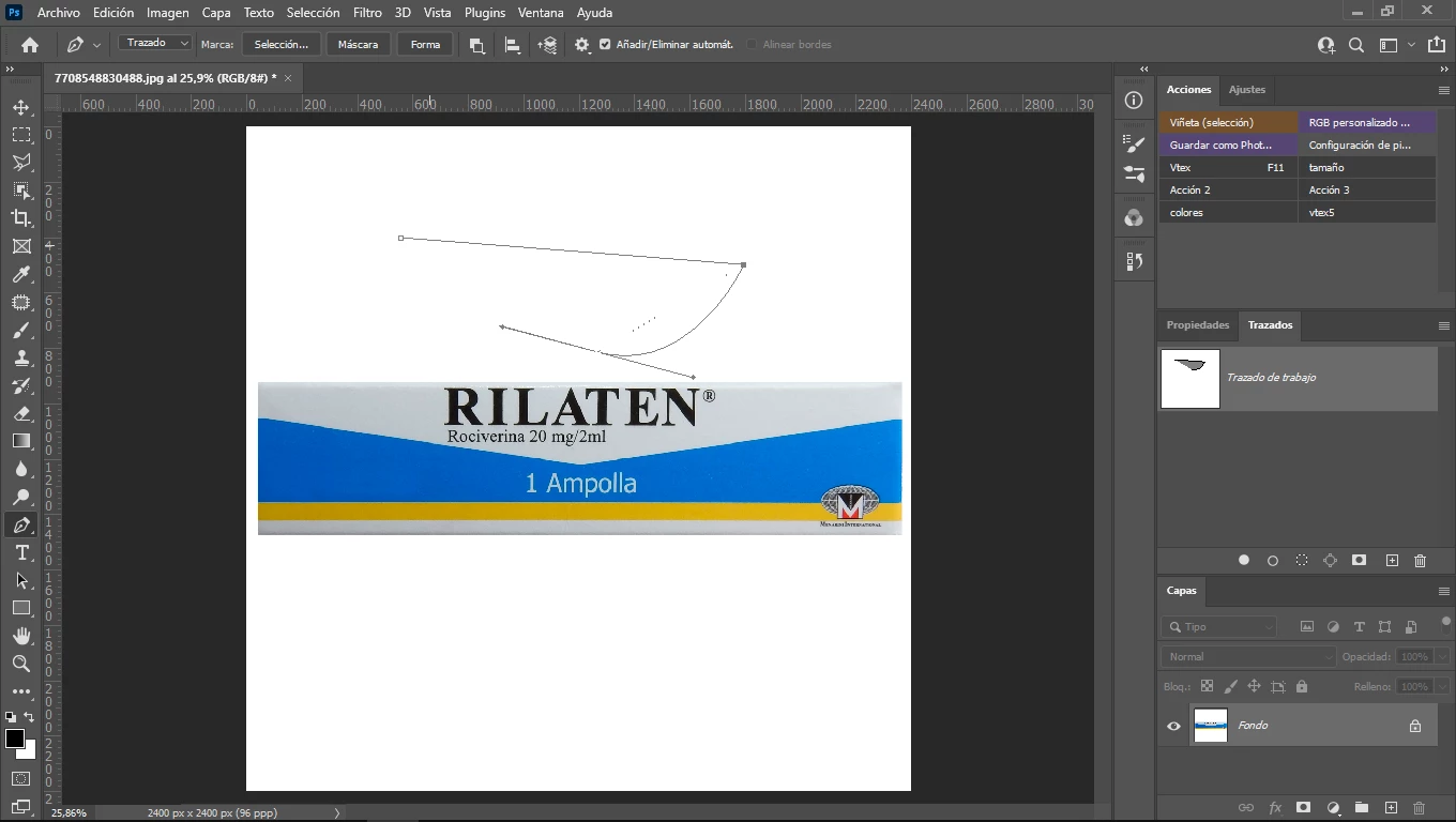

hola buenos dias, aqui se puede ver que el trazo esta echo como lo muestra la ventana de trazados pero como tal en la mesa de trabajo no esta presente solo se ve al quitar el zoom.

Not sure what exactly problem you have. Perhaps some native speaker can understand, I am using translator. From what I can see you using Exclude Front Shape for Path operations (first icon after Shape button in the Options bar). Try to change to Combine Shape and perhaps that will solve the problem?
