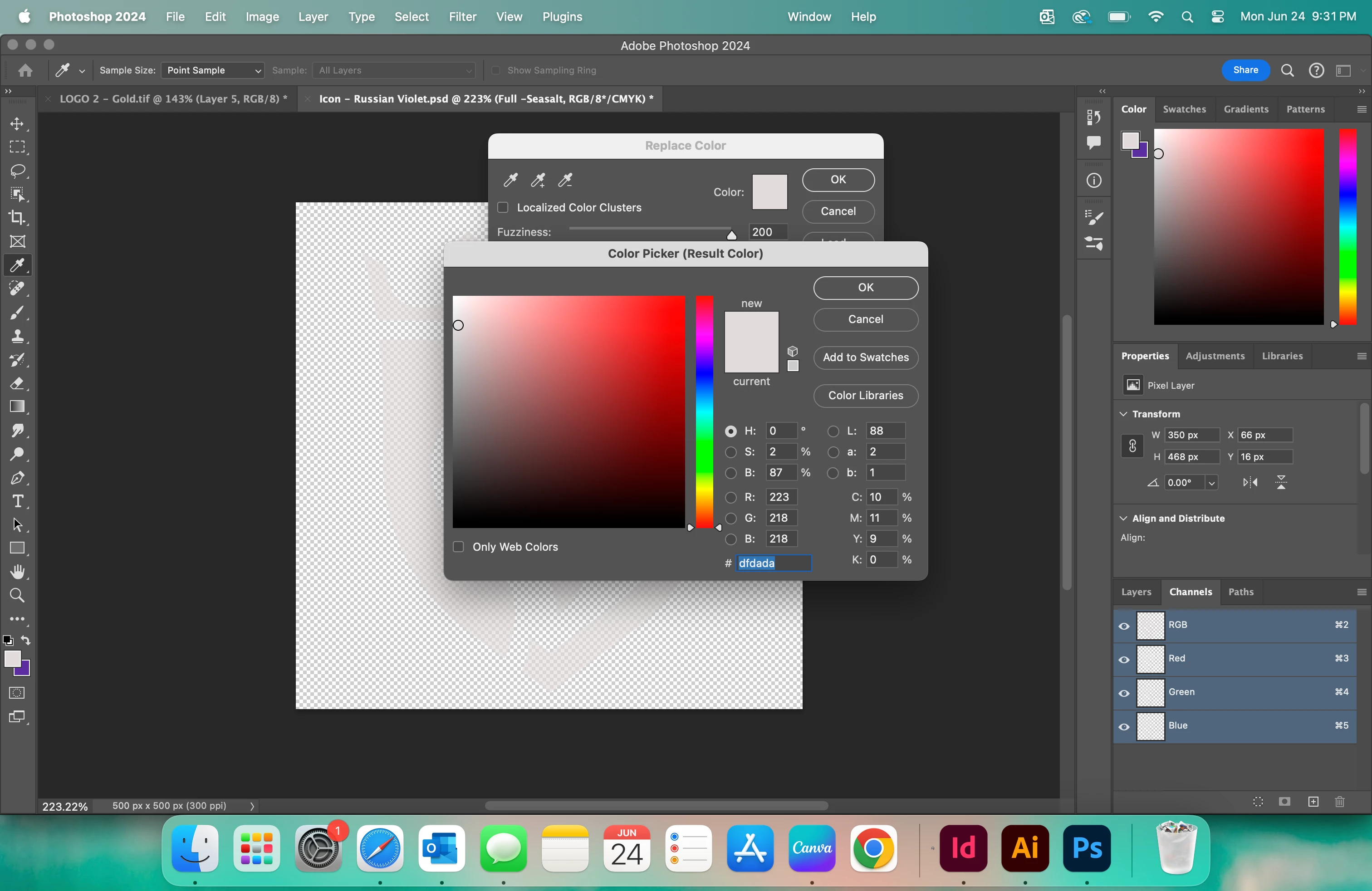

I'm trying to change the color of a logo to another brand color using a hex code. After doing so, it automatically changes to a different hex code! Sometimes it's a very similar color and sometimes if its a gray color it changes to tan. How can I fix this?

June 24, 2024
HI!
What version of Photoshop are you using? Can you show us a screen shot of your image in the window with all of the panels that you are using open so we can see them? How are you applying the Hex color numbr? What color mode are you in? RGB?

hd817Author
June 25, 2024
I'm using Photoshop 25.9.0 on macOS 14.3 (not sure if that matters). For instance, the color I needed for this one was f8f8f8, but it changed to dfdada once I clicked “ok”.
mglush
June 25, 2024
Thanks for the screen shots! I think Chuck asks a great question about which RGB you are using and could be the contribuiting factor.
Is this logo going to be used in print?
Because f8f8f8 is c2. m1. y1. b0 -- which is basically white. The percentage of color you have in that hex number will not be visible if you are going to use it for print purposes. The RGB values are 248, 248, 248 which again is only 2 less than white 250,250,250. What color are you looking for?
Please let us know the rgb profile and how you will be using the artwork?
