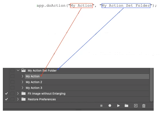

hello. I was busy with other things. I checked the script - everything works as described. Question - how do I create a sequence of actions to replace your function ResaveAsPSD ?
Stephen Marsh
April 30, 2022
@AndreyLarush
I posted multiple scripts. I believe that you are referring to this one:
What do you wish to change in the ResaveAsPSD function?
Do you wish to save the processed file into another file format than PSD?
If you wish to process the file using an action/action set, then you can use the name of the action by adding a single line of code to the function, as per the following screenshot:
Otherwise, you would add in scripting instead of an action. Do you know how to script?
