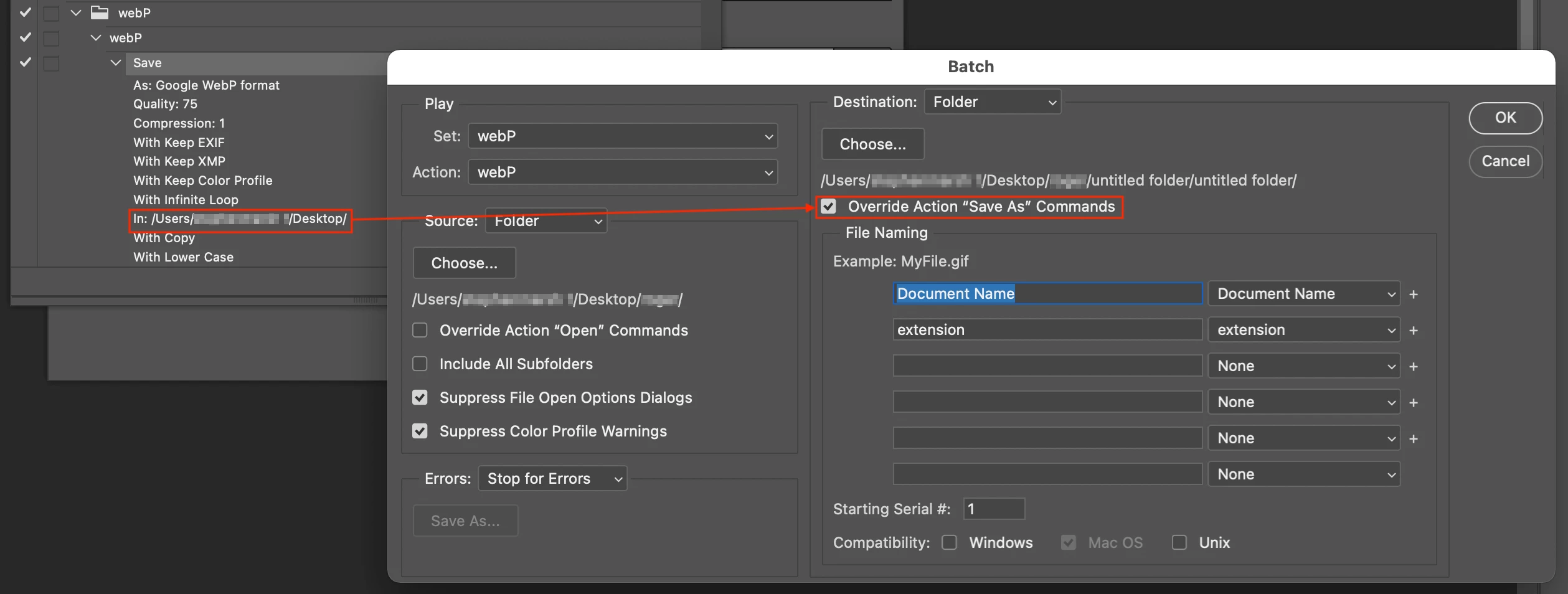

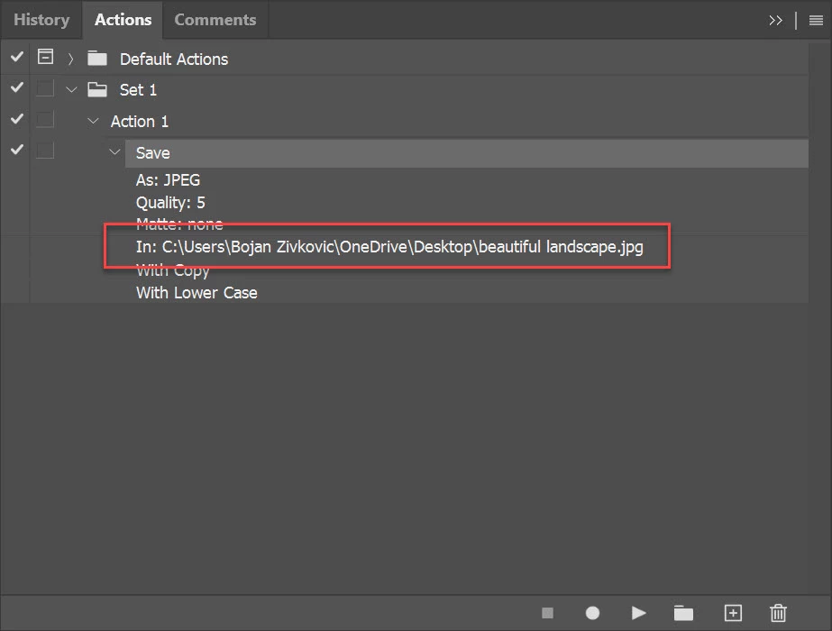

Expand and take a look at Save step. You probably have recorded exact path and file name in action step what is causing action to always write file in the same folder with the same name what is causing overwriting.
