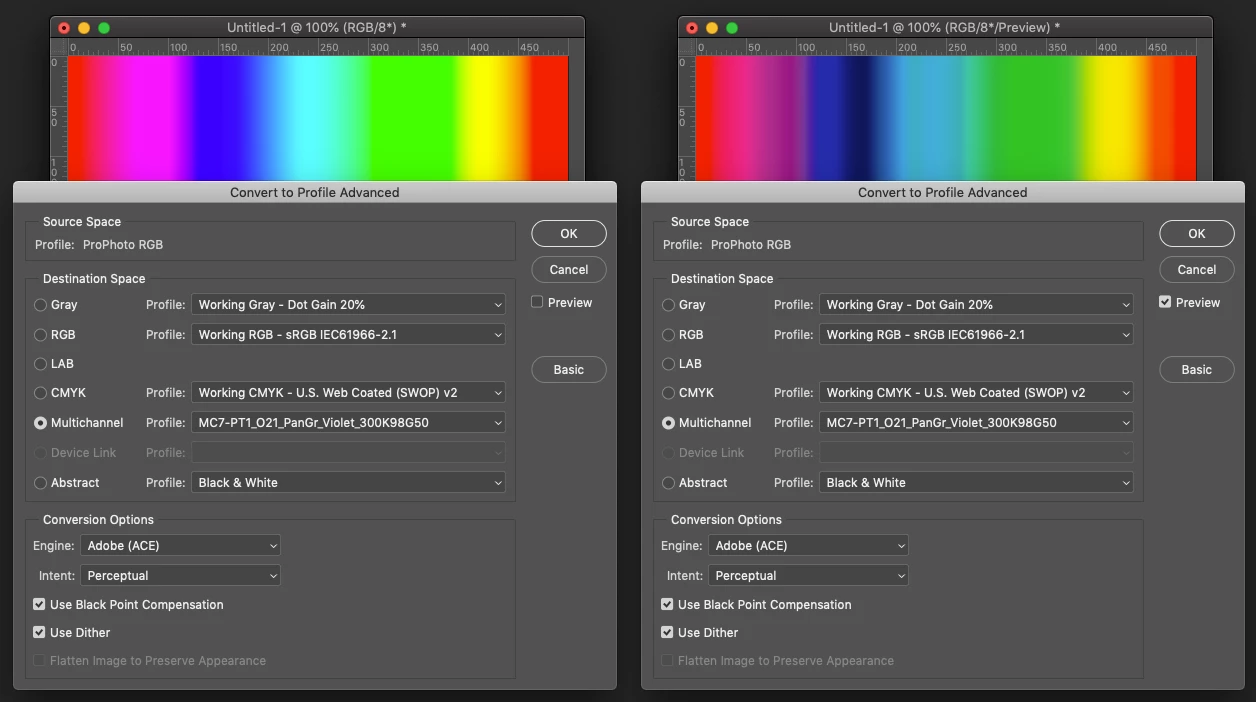

You can create a multi-channel ICC profile with the appropriate ICC profiling software and Photoshop can separate to such a profile using the "Advanced" Convert to Profile option:
This is not something that really works well using "generic" profiles, best results would be for the printer to do a press run using supplied 7 colour profiling targets, then you would measure in the charts and create the profile. If you don't have the software, hardware or knowledge to do this, then I would recommend hiring a consultant to do this for you, so add that to the budget.

I tried to follow your advice but the multichannel option is disabled. How can I activate it?

Could you please post a screenshot with the pertinent Panels (Toolbar, Layers, Channels, Options Bar, …) visible?
