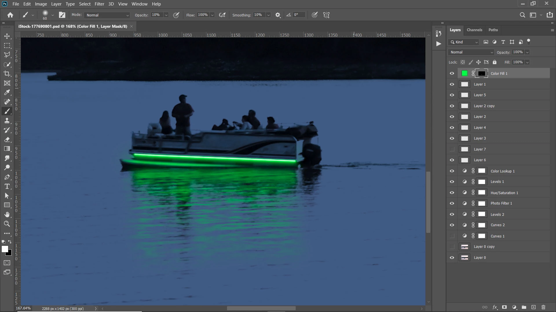

How can I go about creating a realistic highlight reflection on water?
  • February 20, 2020
  • 1382 views
I'm trying to add LEDs to the side of a pontoon boat and am currently working on how the LED light might appear on the water's surface. However, I'm having trouble understanding how to proceed. None of the layer modes seem to do the trick. After studying several photos, it's clear that the highlights really only appear on the wave peaks, leaving the troughs relatively dark and untouched. If anyone has advice on how I might be able to accomplish this and make it look as realistic as possible, I'd appreciate it! Any feedback on what I've done so far would be helpful as well! I've included the PDF as an attachment.
Thanks guys.
Correct answer Chuck Uebele
Here's a video of what I did.
https://www.youtube.com/watch?v=UmNwAUgBkEk

Chuck UebeleCommunity ExpertCorrect answer
February 24, 2020

That was a well organized, easy to follow, and extradordinarily helpful video. Thank you so much for putting in the effort!

You're on the right track about the troughs being dark and untouched. However, with the boats reflection it is mostly dark next to where the lights should be the brightest. In my sample, I cloned some waves away from the boat onto a channel that was darkened to tone down the highlights. They that was used to paint in the green fill layer that I created. the mask was a bit harsh, so I added a motion blur.

Thank you very much for the help! I love the way you created the LED reflections. Do you mind explaining a bit further on how you did this? I'm not exactly sure how to use the clone tool or take advantage of channels. Whatever you did here looks excellent though.
