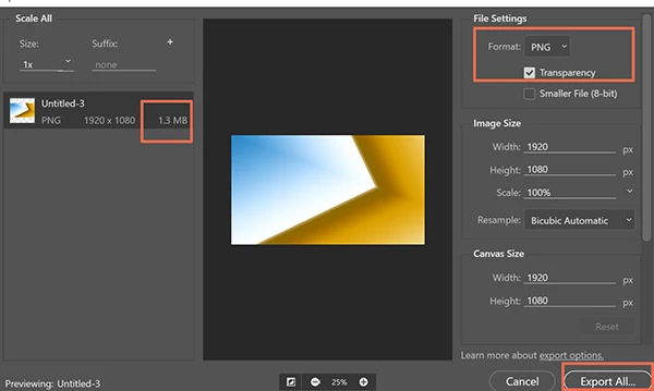

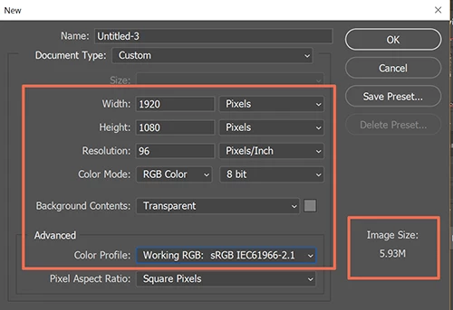

Start with  a new canvas of required height and width and 96 PPI (current web standard).
I would use File > Export > Export As PNG (default) with transparency. That will shave off about 4 MB.

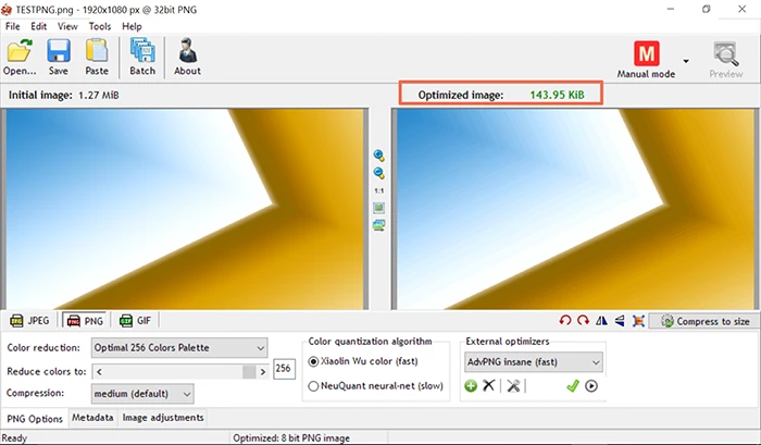

Run the resulting PNG through RIOT (Radical Image Optimization Tool) to bring the file size down even more.
http://luci.criosweb.ro/riot/
In RIOT, the before image was 1.27 MB.  After,  image optimized to 144 KB.  If you need it smaller than that, you'll have to reduce the height and width because PNG files are very heavy compared to JPG.

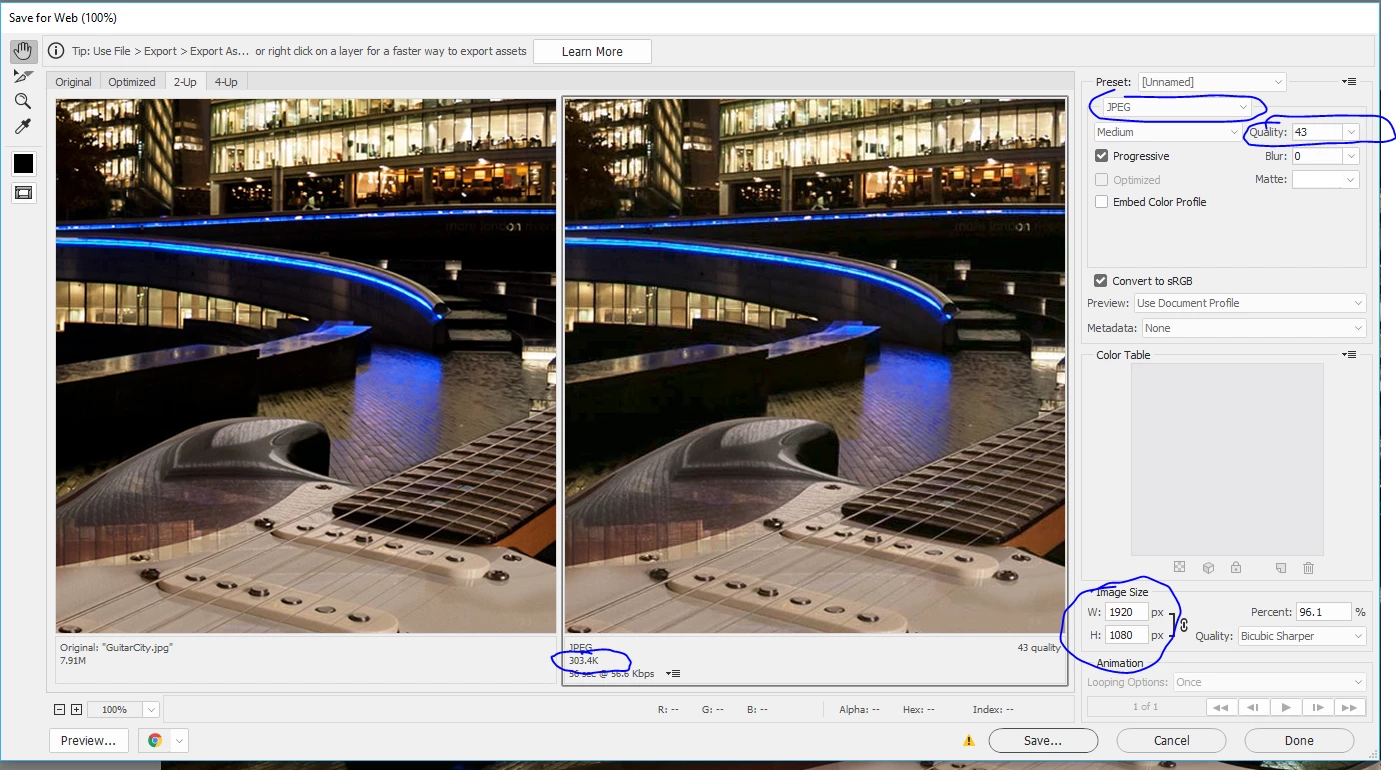

Make sure that the ratio of your sides matches 1080x1920 (if not use the crop tool set to ratio) and crop it
Then Use Export - Save for Web (Legacy) and in the dialogue box:
Set the file type to jpeg
Set the Image size to give the required pixel size
Adjust the quality whilst watching the image size change in the preview to get to your target 300kb
I hope that helps
